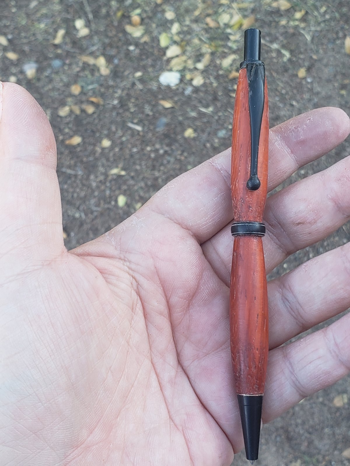

I made my first pencil. It's not great but I'm trying. What grit sand paper should I use?

As you gain experience you will find yourself relying on sandpaper less and less. When I do use it, I usually start with 400 grit. That's a pretty good first attempt. I can see areas that need improvement. Truth is your probably where everyone of us were on our first pens. You will surprise yourself how fast you improve. I'm by no means an expert, but I have definitely learned many things from this forum. Just learn from your mistakes and keep moving forward. Above all else have fun.

It looks to me that you may have turned off too much wood on both sides of the center band, altho the nib end and the top end look about right
