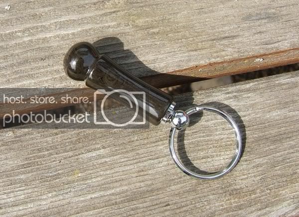

Ebonite comes out with a very deep shine with proper finishing.
Here is a keychain I did with some of the Ebonite we produce at work.
