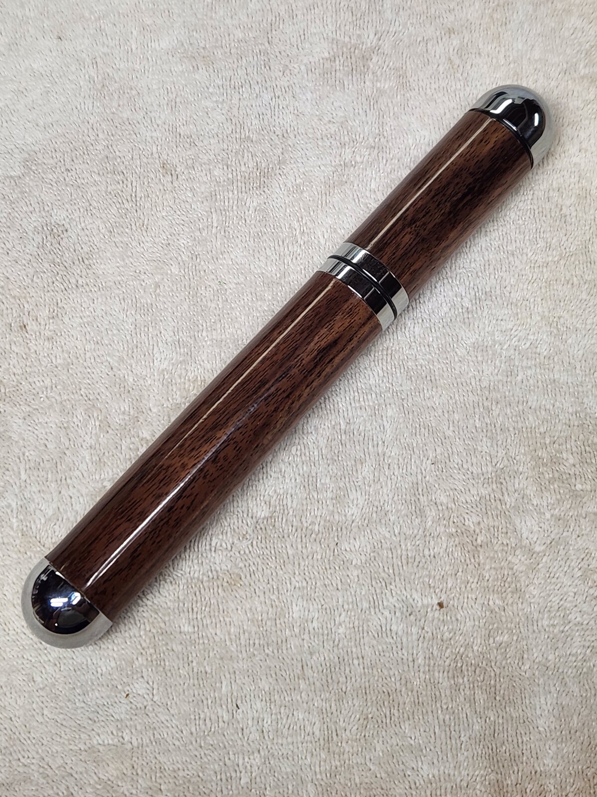

I'd appreciate some thoughts and ideas. Sharing a quick photo of the Craft Supplies one I did last night.

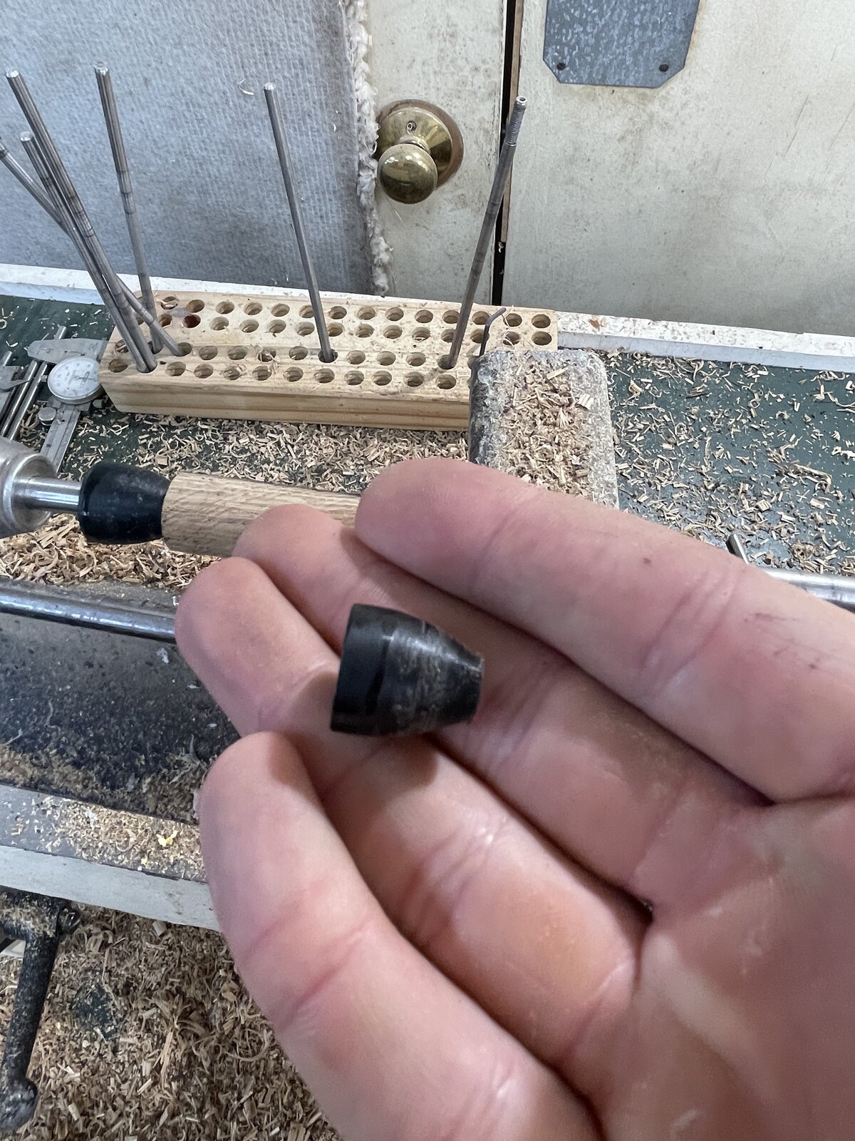

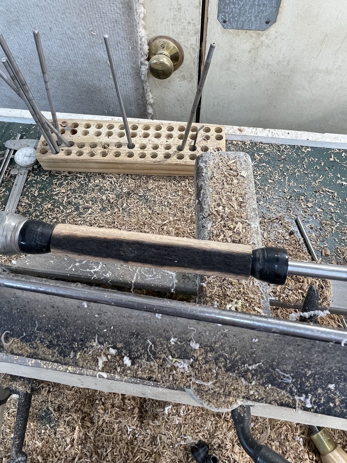

I have a buddy with a 3d printer that printed off a bunch of these larger plastic bushings for me. I use these to finish the majestic full size pens. I'm able to reuse them and use my turning tools to take the CA glue off. Let me know if you are interested in some.
