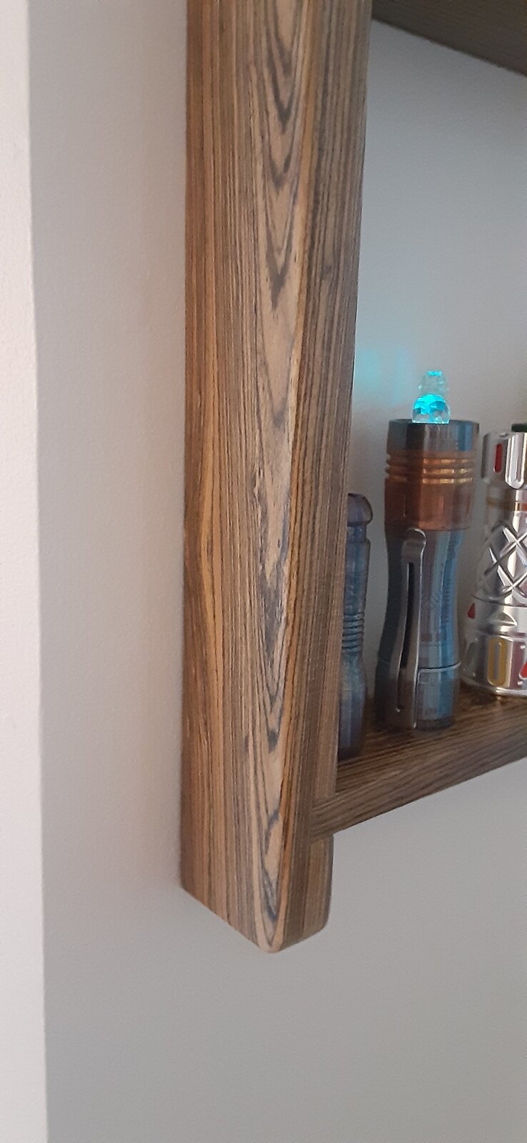

I've used a LOT of bocote. I just finished a small shelf. Two coats of General Finished HP. Very natural looking. Never had an issue with getting a finish on. Just sand to 220, raise the grain, and use 320 to knock the raised grain off.
I've used a LOT of bocote. I just finished a small shelf. Two coats of General Finished HP. Very natural looking. Never had an issue with getting a finish on. Just sand to 220, raise the grain, and use 320 to knock the raised grain off. View attachment 379770
Very nice looking shelf. Love the floor you've achieved with that finish. It's not overly shiny either.
