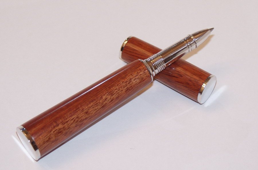

I haven't had any problem with bloodwood. I sand to 400 grit and then micromesh to 6000. I apply a few drops of BLO and follow immediately with a few drops of medium CA. I do this three or four times and micromesh to 12000. Lathe speed is about 1100 rpm during this process. Here is a picture of the result.
