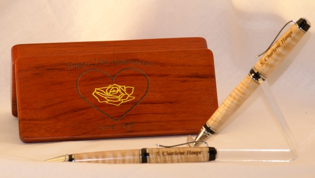

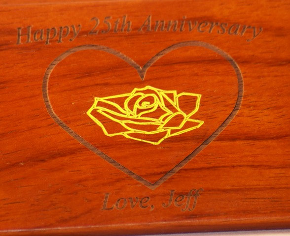

Had a few orders I finished this past week.... First a pair of Maple Cigar Pen & Pencil set. Engraved a pen box to go with them. I went to John Driscoll's shop for the engraving. He's good!! We had to do the box in two stages.. First the pose and color-fill. Then the heart and text.

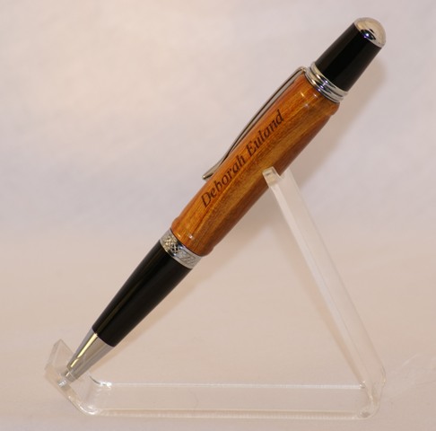

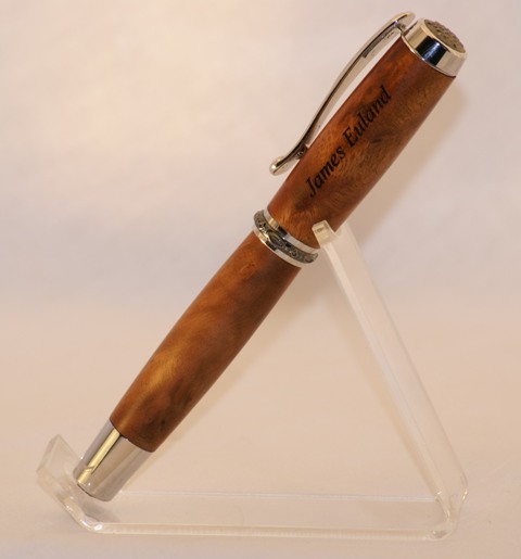

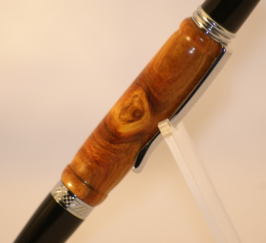

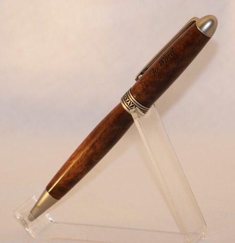

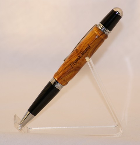

Here are the other four pens from the other order that John engraved for me:
Two Texas Mountain Laurel (Mescal Bean from Curtis) Chrome Sierras. The first one had such beautiful grain, that it was almost a shame to engrave it and cover the wood....
Then an Aboyna Burl Satin Nickel CSUSA Euro and then a Saigon Cinnimon Jr. Statesman Chrome.
All pens from both orders are are finished with BLO/CA and buffed Tripoli, White Diamond, and Carnuba Wax.

Great work on all the pens. I like the malpe alot. I assume that is curly maple??? I see you got the figure to stand out, did you use blo or anything to highlight the grain??? What was your top coat choice on all of them??? Thanks for the reply.

I use the same finish on all of my pens. I sand 240, 320, 400, 600, and somethimes 800 grit. Then I do three coats of BLO/CA. I follow most of the procedure that Don Ward taught me a couple years ago.... http://content.penturners.org/articles/2006/donwardca.pdf
I then buff them on my homemade Beall style buffer with Tripoli, white Diamond and Carnuba Wax. I don't use HUT Polish or TSW like Don does....
