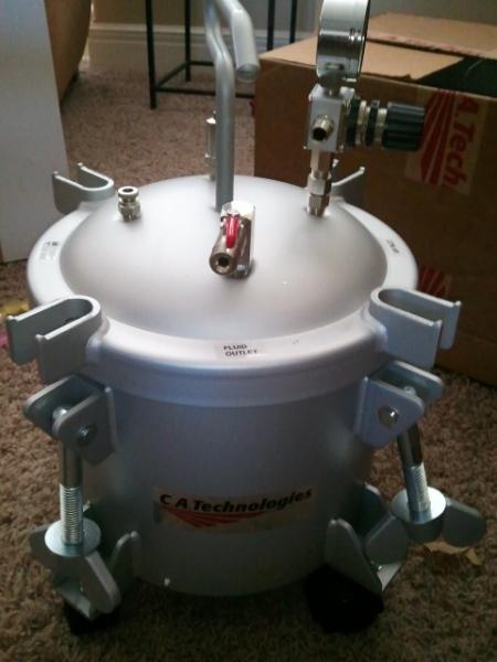

I finally decided to purchase a pressure pot. After reading all the different methods of casting, I decided that the pressure pot would work best for everything I might want to do in the future. I had read all the reviews on the HF Pressure pot - along with all the failures - and it had me concerned. So...I decided to find the safest pot I could find. I ran across the Finsih Systems pressure pot and it looked like it was sturdy and well built - so I spent a little more than others I have seen and purchased it (http://www.finishsystems.com/resincastingpressurepots.html).
I thought I was getting a pot that I could take out of the box and put to use without having to make any modifications. However, now that I have unpacked it, it appears as though I will need to plug a few holes...maybe? Do any of you have this pot to tell me what I might need to do?

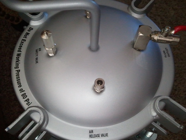

My first question is the air release value (see picture below), does it need to be plugged? OR If I need to leave it in for safety, do I need to just make sure it is screwed all the way in?

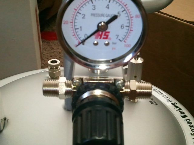

Second question - see the picture of the regulator. I am planning on attaching a quick disconnect to one end of the regulator. The directions show the other end being connected to the air hose (if I were using it as a paint sprayer), because I am using it for casting, do I just add a cap to block that end from allowing any air to escape?

I use these pots, best pot out there in my opinion. Do not remove pressure valve and air release screw stays. Plug the paint exit hole only. Don't install wheels. Go to hf or auto store get the hose piece that has a pressure guage and a trigger and an attachment to fill tires. Remove tire piece from hose and will screw right into lid! Put quick connect on other end of tire filler thing, done. That whole piece is $10 at hf. Quick connect a buck, plug lessd than a buck. That's all u need. Pull trigger fill pot. Turn screw on lid release air or pull trigger to let air out.

I think what he's saying is to buy that part to use as a pressure relief valve. That way, you'd at least have something that's useful for something else. The fact that it have a gauge doesn't matter. But it will be helpful if you use it to air up your tires.
I'm saying buy and use that instead because it is simpler to use and install and because its flexible it won't risk getting banged up. You can use parts that came with pot just need a valve to turn on off and quick connect. Thing is though, now u build a tower of metal fittings and the more connections more risk of leaks in system and if u wack the tower by mistake like say swinging a sheet of plywood around in shop you can break the parts off. You decide how u want it, its just my opinion the tire filler thing is easier and works great. The guage is built in and so is trigger, I think its sweet and its cheap. When you see article and pic you'll understand.
If you had an HF pot, you'd have had to build a tower of parts off the lid in order to keep the safety valve. The CA pot is different, it has a seperate safety valve built on to the lid and is far less flimsy than the HF one. Your going to like this pot. It is a touch shorter pot but its a bit wider and wider matters more than height.

Does anyone know what the release valve is set to? I have the pot holding at 52psi and if I go to 53 the vavlve triggers.
The "built in" safety valve on mine goes off at 80 lbs. There is a screw on it that adjusts it is there not? I haven't had to fiddle with mine, but it seems to me there's a knurled knob on it that you can tighten up more.
With PR, 52 should be more than plenty, with Alumilite, that is the recommended pressure as well. I typically run 60 lbs.

Jeff - Thanks for your post. I noticed that my guage would stick at 52psi, so I put a new guage on it. Once I got the old guage off, I noticed that the back piece behind the needle was bent keeping the needle from moving and actually got stock on the indicator. Evidently I was putting more than 80psi in the pot. :eek:
I think that I would be peaved if I paid nearly three hundred dollars for a pot and it came with a bad gauge.
You could pay 80G for a hummer and have a tire fall off 2 blocks from the dealer. Things happen. I would certainly hope that the new part came for free from the manufacturer. I wouldn't want to install a different kind of pressure relief valve anyhow, the one they provide is really good, and I like the location of it too. Did you get the new one from CA Tech?
Jeff, I called them and they got a replacement out the same day as my call. They took care of it and that is all that mattered to me. Would I buy from them again? You bet I would. Would I buy this pot again? After what I went through, I am very glad I went with this pot. What if that had been a bad gauge on a HF pot? I know I put 80psi in that pot and it held. I saw what Curtis' pot did, the extra money was worth the peace of mind
