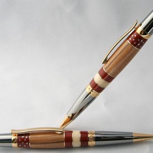

Somewhat different but still similar enough. Look at the pen below and notice the brass and sliver solder dots. How do you sand without smearing. That was my problem and with some thought and some fine honing on my HSS scraper, I learned that a very sharp scraper with light touches, 2500-3000 rpm produced smooth finish on the wood and brass and solder dots without smearing. I wanted a CA finish so I built up a thick coat of about .007 or .008 and sanded down to about .005 thickness so that I would NOT sand through to the wood. BTW, After learning to use light touches with the scraper to smooth everything, I started using the scraper for light touches on the CA and produced a fine finish on the CA. With that done, I rarely used anything less than 8000 MM and often used buffing compound only to bring out the smooth shine.
It is not unusual for some skilled turners to not use sandpaper at all in some cases, but use a finely sharpened skew or scraper which prevent contamination.

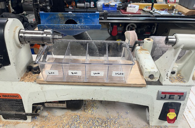

In terms of your water, I use a multiple compartment container I got from Amazon and place it on the lathe while sanding. This is my sanding setup for resins and acrylics. Wet sand and add a small drop of dawn to each compartment with water. This also keeps my sandpaper grits separated so I don't accidentally use the wrong one. The Dawn helps prevent the sandpaper from getting clogged with the grit being removed.
I really like this idea. I am gonna give this a try until I get good enough to avoid as much of the sanding! I hadn't even thought to use multiple water compartments haha. It seems so obvious now.
