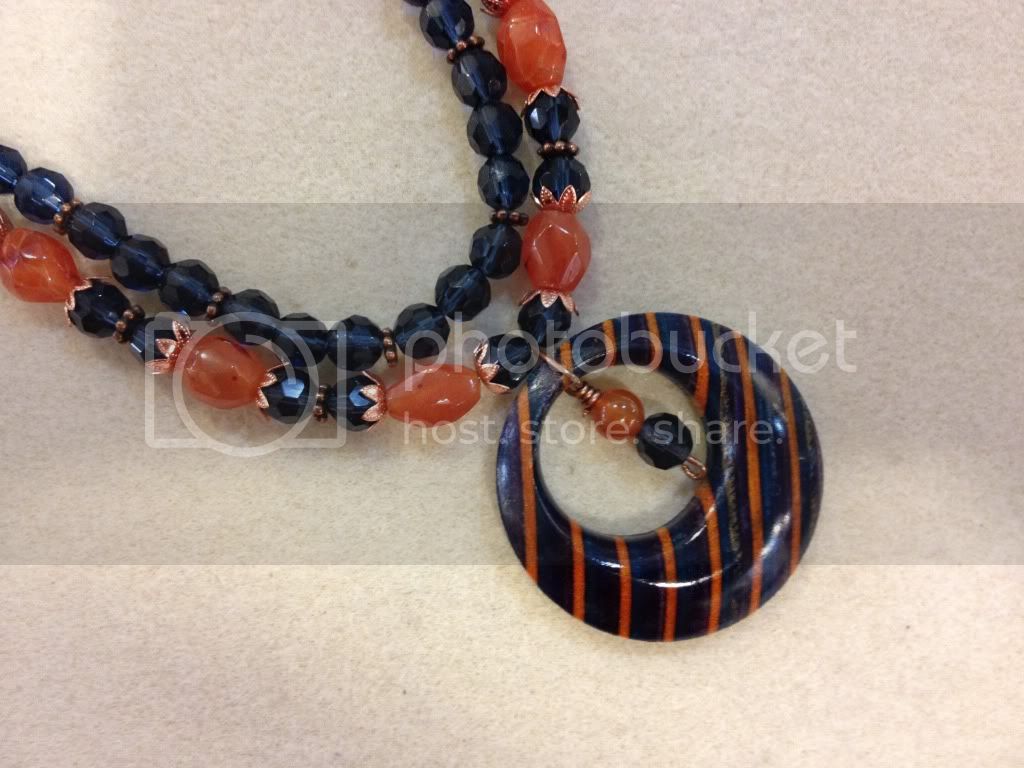

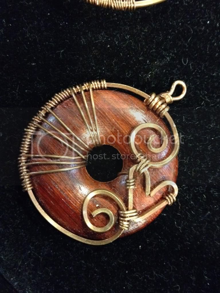

Thanks dan. These are roughly 2" diameter. Hole saw needs to be 1/8 larger than the desired size so that you're getting the inside rather than outside diameter. I have made earrings using a 3/4" as we'll as 'donuts' from 1.5"
Donuts
Wire wrapped donut (collaborative effort with my fiancé)
Pendant finished
