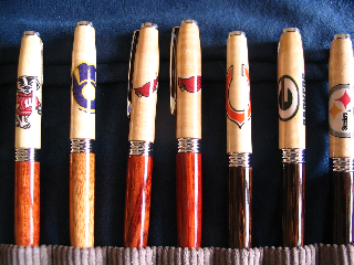

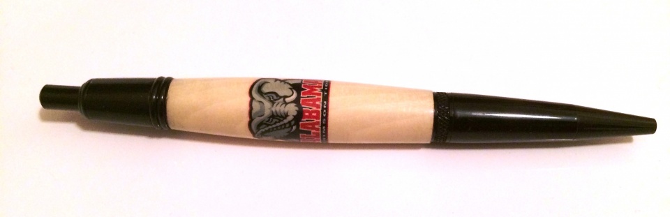

Hi,
I do decals all the time. They usually show up on Holly and Maple well. I use the laser printer because I can print and go, no waiting.
Printer Paper: DecalPaper.com - Decals - Waterslide decal paper or inkjet,laser printers Alps & copiers - (Clear) Whether you have an inkjet or laser. I buy the 100 sheet package. It lasts a long time.
Images - I use powerpoint to resize my images and to sort them. Then I just print.
Jim Mahan is the one who taught me and the only difference is the printer.
Hope that helps!
Jon David Jones

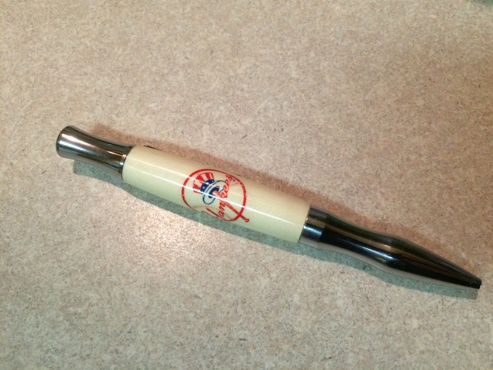

I made this one using the Testors kit from Hobby Lobby and an inkjet printer.
The logo is my Sons high school wrestling team and motto

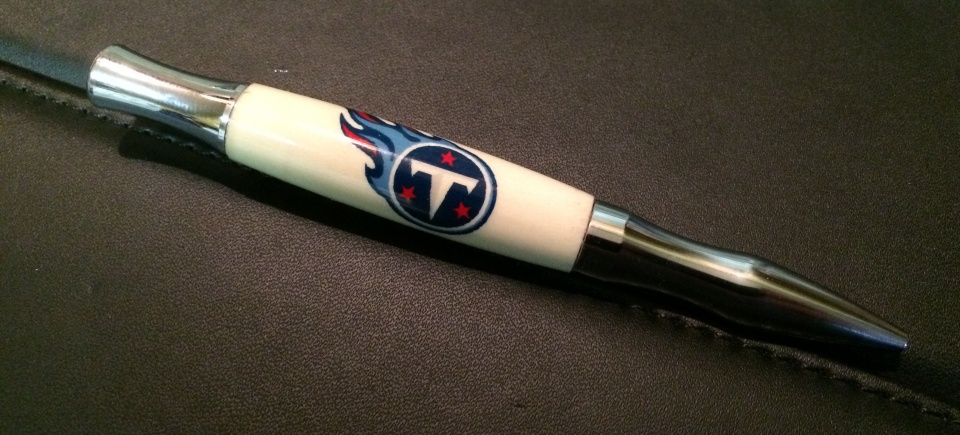

I have been wanting to start putting decals on pens,,but its really hard to find them,,i have been told the waterslide decals like used on model cars is the right ones to use,,but I have had no luck in finding them,,small enough for pens that is,,does anyone know a supplier that I could order from and actually I was looking for decals for team sports,,any help would be appreciated,,thank you,,
You have to print your own decals with images you want and size them to fit your pen blanks
Testors either Clear or White is what you need to print on
Les

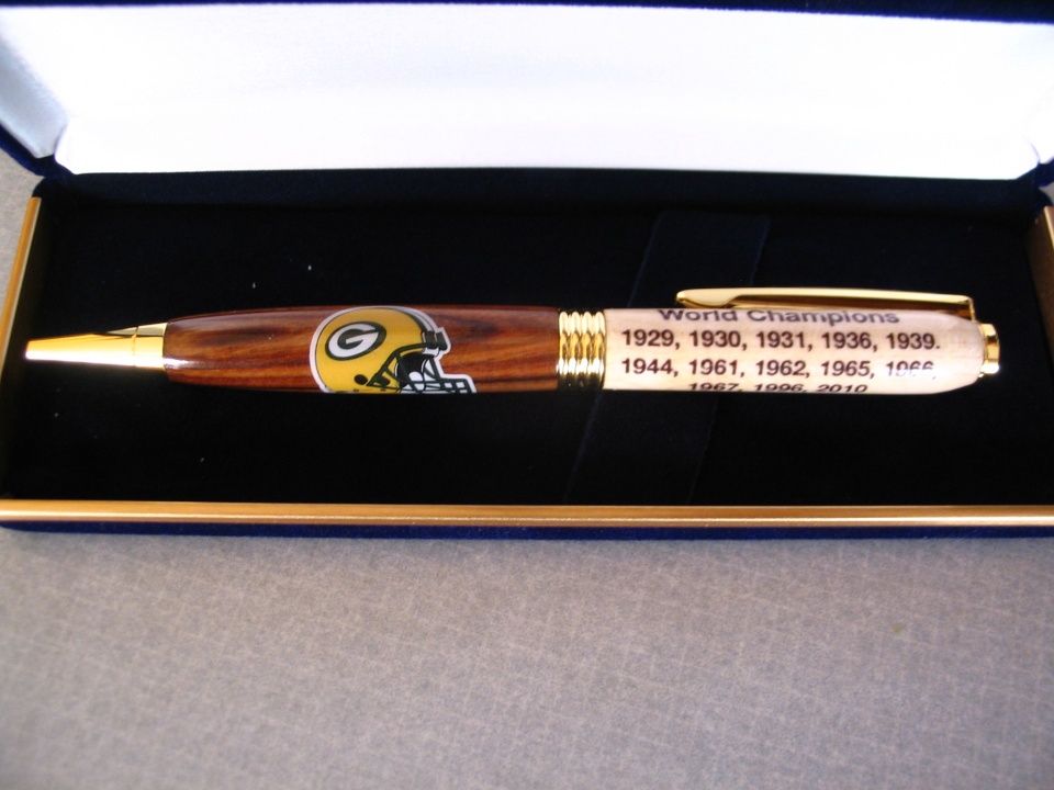

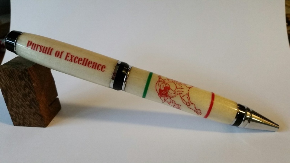

Here are a couple I made in past, the Packer pen Championship years are waterslide I made off an inkjet.
