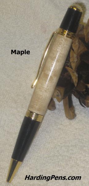

Try the dowel rack at a small hardware store. The big box guys are bringing in Lauan and other Asian wood dowels now, but the small guys often still have good local woods. I can still pick up Maple dowel at Home Hardware and Canadian Tire often carries Red Oak dowel.
These make simple, plain looking pens, but the wood is cheap and they sell surprisingly well.
