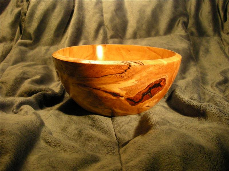

Steve, when I have a crack or void in a bowl, I've used regular two part epoxy mixed with crushed instant coffee. No vacuum or pressure pots to worry about - put it in, let it dry for a day, turn it off.
