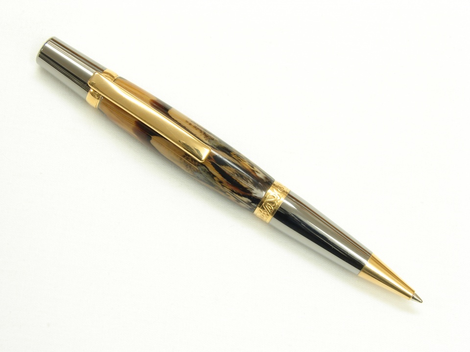

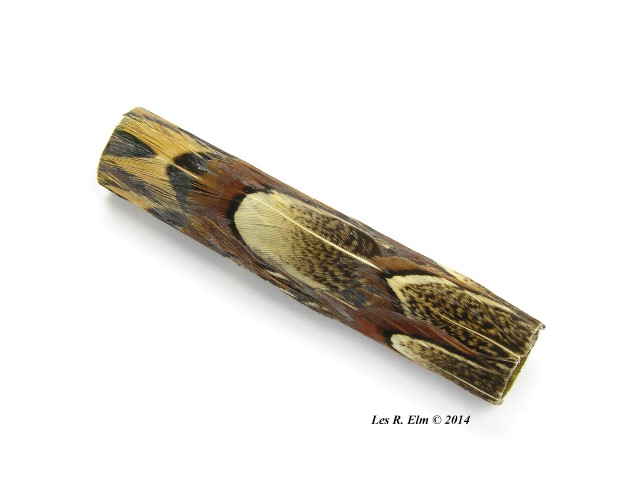

I use Polyester Resin with Pheasant feathers
PP is a must as the feathers like to trap air
Les
