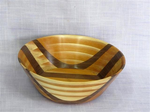

There is a reason why Ringmaster recommends tight grained hardwoods for making bowls . There is no problem with the alternating end grain cutting and sanding of hardwoods . I have got by with softer woods like Fir and Pine but a friend gave me some cedar boards and I wanted to try and see what would happen with that being so much softer than anything I have tried .
I laminated the board with some walnut between the cedar and sure enough , even with very sharp cutters I got enough tear out on the end grain on both sides that it took a lot of extra sanding and never did get below it so I rubbed some glue into the pores hoping that sanding it right away would fill them with sanding dust . Well it did but also made the filled part a lighter color . So lesson learned , I wont try cedar like that again .
BUT . . . I think I will try a segmented one with the same wood because that way every segment would be face grain on the outside and no end grain to be shown anywhere. .
If I try it and it turns out OK I will do a follow up to show the difference.
Oh yes , even the plug cutter cut rough with that very soft wood so will try to re-sharpen it before using it next time.
Here is the 9" diameter bowl

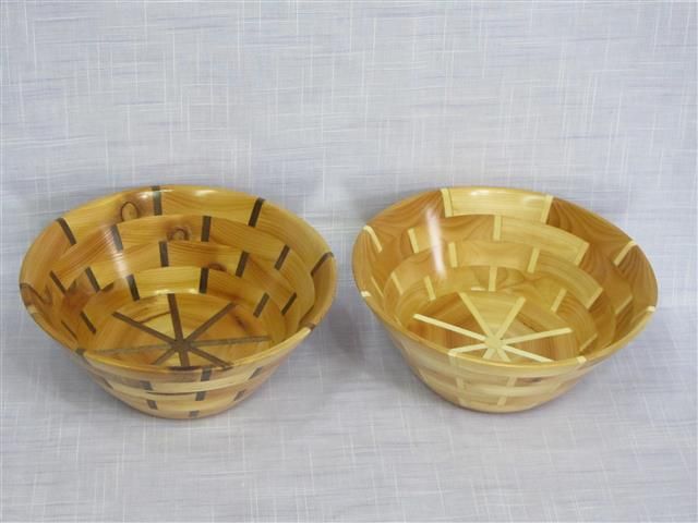

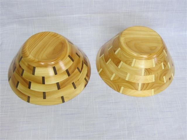

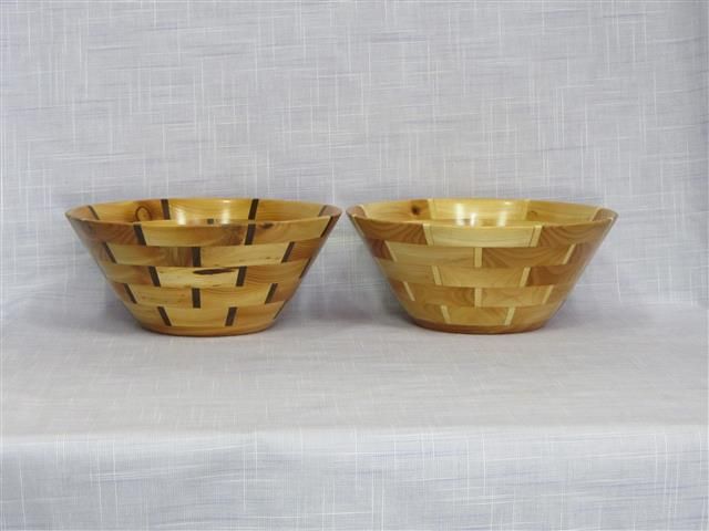

I glued a couple more cedar boards together but this time it is segments with face grain all around so we'll see how that turns out.
Conclusion of this experiment .
Glued up a couple flat boards into segment style and turned them into bowls .
Yeah . . . nice smooth cuts and easy sanding because there is no end grain to deal with .
Moral of the story is that practically any kind of wood , soft or hard can be turned into a bowl from a board with the help of a Ringmaster . Just a matter of ways of going about it. .

Thanks.
The knots are sealed in with thin CA before turning and sanding and then again with two coats of shellac as sanding sealer before spraying three coats of WB lacquer .
You know what they say . . . it's not finished 'till it's "finished"
