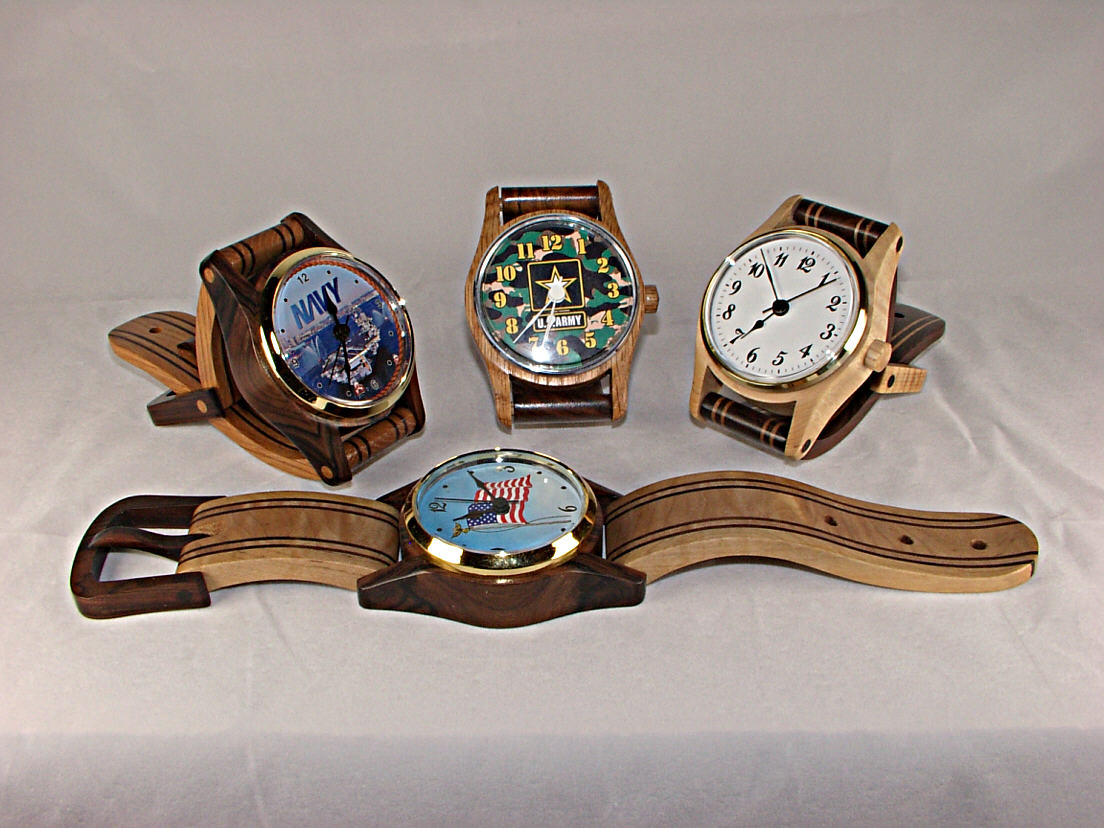

I just checked and it so happens back in 2010 I ordered from the same place as Eric mentioned and linked to. Was very happy with results and still have a few. I use them when making my desk watches. I use to put dots within the bands. Sorry I did not take any photos back then because I was not big into that stuff. I also used them for the pins to hold the bands on. Also I looked at one time back then Woodcraft was selling out of all their exotic dowels and bought them out. I use to have a woodcraft store here in NJ back then.
Heck I just wanted to try my new computer and my data storage update and see if my files got transfered and it looks good to go. I am a happy camper.
