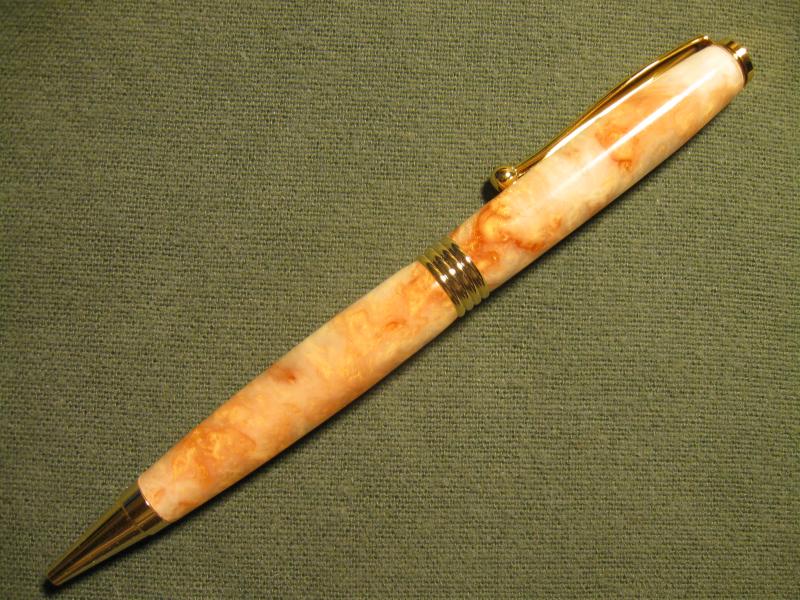

Look for a blank called Crushed Mud I attached a pic for you to see.

Seer,
That's about the texture I'm looking for. Maybe a bit less yellow/red in the color- more toward the grey/tan/white I'm thinking...
