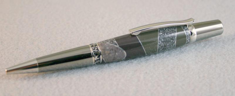

I have been trying to do scallops this week with a strip of Aluminum in between the pieces. After gluing them up with Epoxy I decided to cut the excess off on the bandsaw and with just slight pressure the pieces popped off. it seems like the epoxy does not keep the aluminum stuck to the wood. Any suggestions?
