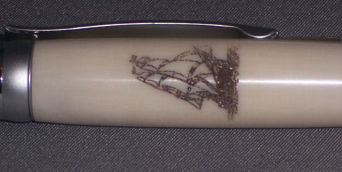

Alt. Ivory blank from Ed4copies, Laser engraved locally
