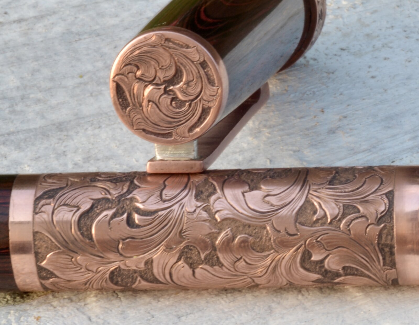

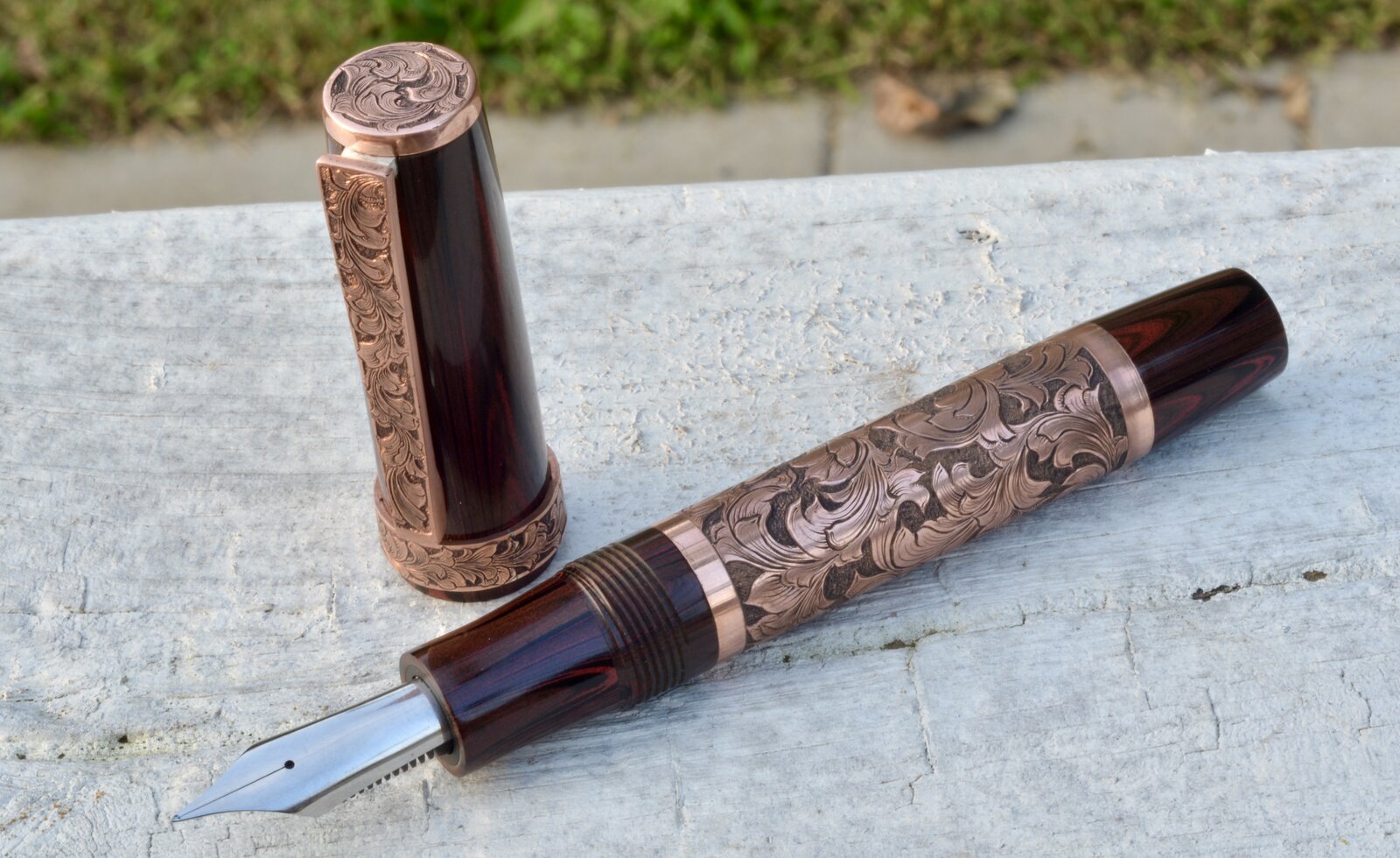

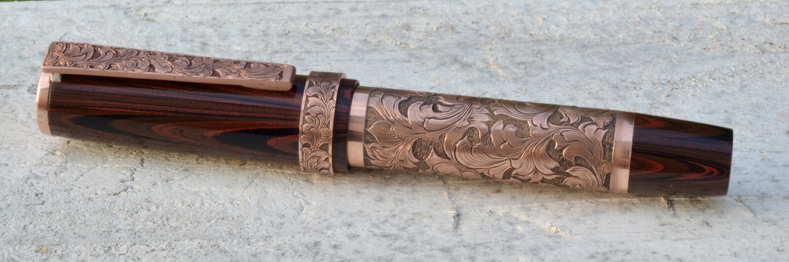

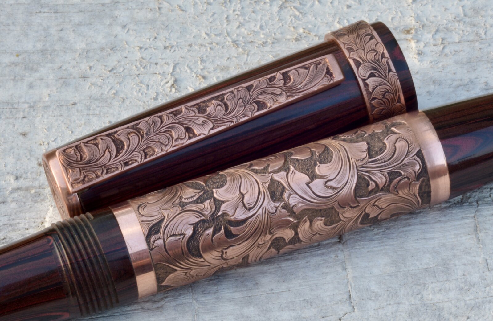

I didn't start out with the intention of making this pen. I bought a 10' length of copper pipe at the hardware store a while back to practice engraving, and I spent so much time on one of the pieces of pipe that I figured I should incorporate it into a pen. I don't particularly like copper as a pen material, but I thought it would be a shame for this to get tossed aside, so I made an overlay. Since I had no copper sheet, I melted down some pipe and poured it into an ingot, which I rolled out to make sheet stock for the clip, finial, and cap band, which I engraved as well. I made the rest of the pen from black/red ebonite, and cut the grip for a #8 size steel nib. I wish I had a gold or rose gold nib, but I had to stick with polished steel for now.
This is a quite large pen, due to the copper pipe being nearly 16mm in diameter, which I am not a fan of, but I had to roll with it. I kept the length down to About 5.25" capped, which is a useable and practical size to carry.
This is a quite large pen, due to the copper pipe being nearly 16mm in diameter, which I am not a fan of, but I had to roll with it. I kept the length down to About 5.25" capped, which is a useable and practical size to carry. View attachment 341204View attachment 341205View attachment 341206View attachment 341207
