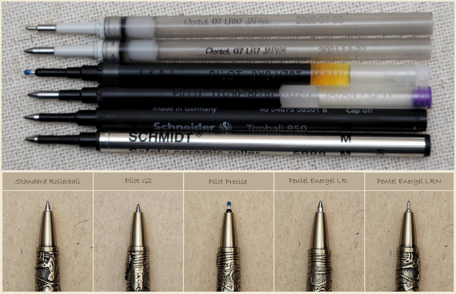

I feel like the needle point cartridges work best in a slimmer rollerball. The Jr. series look a little weird with them. The Pilot Precise is another great cartridge with a needle point gel. Here's a few different cartridges for comparison. These were in a fly fishing rollerball, but the fit is about the same with any Jr. style kit. The extension depends on the shoulder of the cartridge.

Wow Todd - what an outstanding response. The pictures and comparisons are at another level. I prefer the Pilot G2 Broad refills for the Gel ink in my personal rollerballs. I think your comparison information belongs in the resource library. - Dave
Thanks. I have been meaning to expand on that first and then submit it. I've been procrastinating, but I will get to it soon ;).
