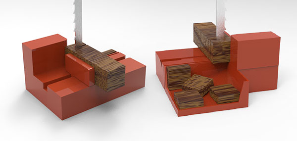

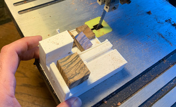

3d printed bandsaw sled for center band blanks
This jig slides over my bandsaw blade and cuts centerband blanks a little thicker than 0.25".
(3d *.obj file attached)
I drill and trim these squares before using as centerbands.
What I like about the jig is there's no setup and the pieces fall away so I can cut a bunch in a row.

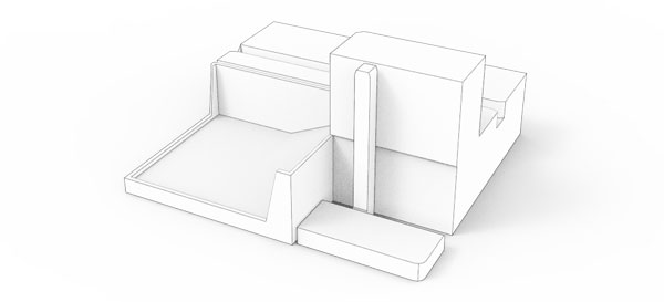

3D printing notes
I took a file to the sled and trench to make sure they slid smoothly
The two pieces print in a pretty small footprint.

Cullen
3D printing notes
