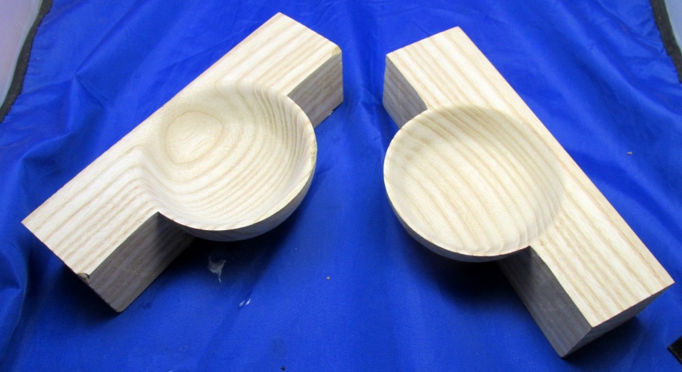

First try and there will be more. Used some ash 4x4"s I had. A little more practice and I will use a nice piece of wood.

Awesome turning Don! An eye catcher and head scratcher all in one.....or in two:biggrin:
One combined turning first and a second turning on each half I presume.
The wings would sure paddle some air while spinning!
Can be done that way but I turned the half sphere first, cut it in half and hollowed out the two bowls.
Don

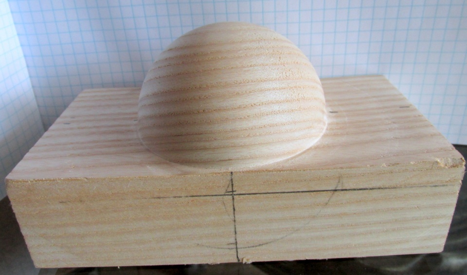

Turned this first; split in half and hollowed out the two halves.

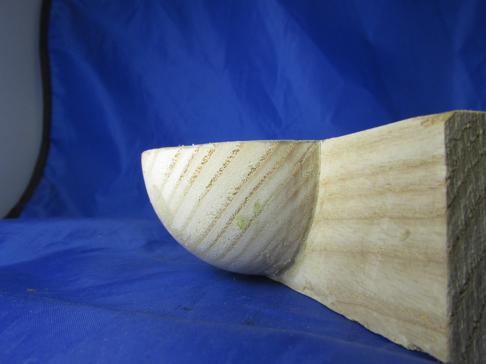

Yup, just watched Mike Waldt video.....going to have to try one some day!
That is what I originally thought but then could not see how you would chuck it for hollowing.
Glue block for both turnings. Careful and accurate measuring required. Use google to search for "emerging bowl woodturning" and watch the video by Mike Waldt.
