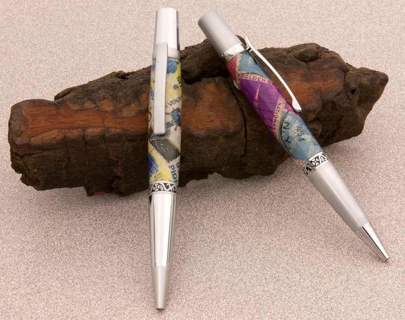

If he doesn't chime in here and you don't get the answers you need, check with Steve (pensbydesign). He cast these and they came out flawless (looking at the photo, it looks like there might be bubbles in the black on the one on the left, but they are not, the stamps are of a NASA Probe, so those are stars in the black of space...) I'm looking to get into doing this too, as it seems that stamps could be a wealth of design possibilities...
