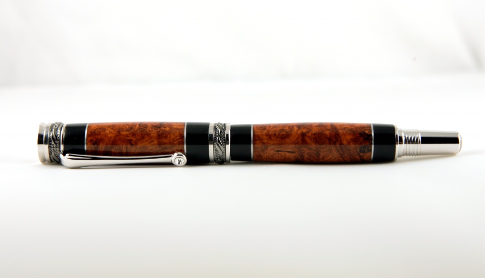

This is my first try working with aluminum. It is made from ebony, amboyna burl, and aluminum strips.
I had a little trouble with gluing the aluminum to the wood/burl. I had to re-glue some of the aluminum pieces before they stayed on. I used CA glue but am wondering if there is something else I should use.
Please let me know if you have any tips on working with metal in pens.
Any comments are welcome.

I use 5-minute epoxy for jobs like that because I believe the working time is longer and I can slide the pieces around a bit until I get the clamp tightened securely. . Perhaps with the thickness of CA you used you have enough working time.
You have made a very nice looking pen there !!

This is a nice job with that pen. The use of materials blends very well and the design is symmetrical which I like. As far as glues go. They have been done with both Med CA and epoxy with all kinds of cure times. I prefer epoxy.

In answer to your Q, have you tried rough sanding the aluminium so that the glue has a textured surface to stick to?
Yes, I did rough sand the aluminum before I glued it. I will experiment with some other epoxies to see if I get a better result.

With respect to the epoxy. Don't clamp it tight like you would white or yellow wood glue. Epoxy needs to have a thin film left in the glue joint. Clamp it lightly so it isn't all squeezed out.

I think that may have been my problem. I clamped it really tight and like you said probably squeezed all the glue out.

That is a great effort Seth - really well matched materials and pen with an excellent perspective on the segmenting. I'm also impressed with the finish - what method did you use?
I used a CA finish for it. I did about 10-15 coats, sanded it with 600 grit, and then used plastic polish. Thanks.
