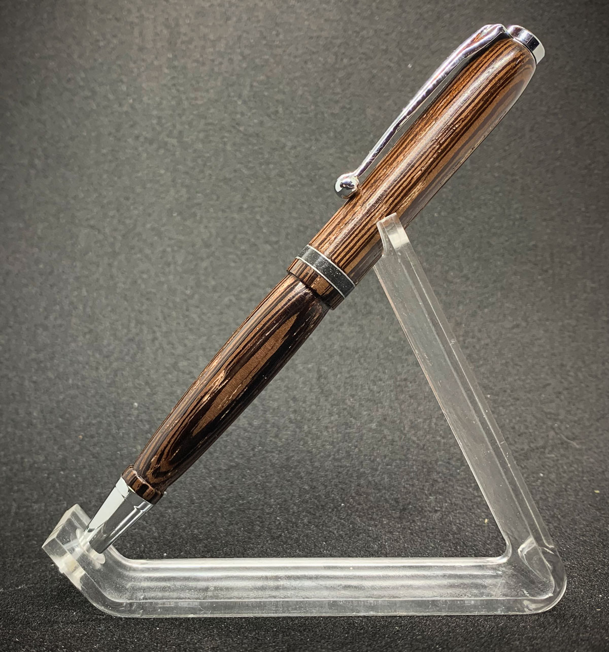

I'm not sure if this process is right or wrong; unique or common. But I want to share in case it's interesting.​
30: Easy Classy Center Band

Wenge with Aluminum Composite ACM Centerband

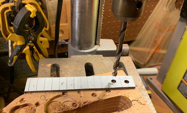

I ordered a 12"x12" sheet for $5.50 with free shipping to my local HD store.

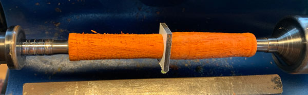

The material is thin, but I drilled a 1/4" hole in the middle and loaded it onto my mandrel to incorporate into a few pen designs as center bands.
[Loaded between padauk blanks]
Prepare blanks using barrel trimmer.
Turn down to within the barrel trimmed diameter.
Reload mandrel with centerband material.
Turn down together.

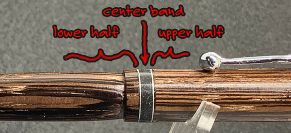

One advantage to turning on a mandrel is I can "see" how the upper and lower sections work with the centerband.
I can decide where the visual breaks are, even if they don't line up with pen components.
This Aluminum Composite is budget-friendly, easy to use, and a great new material to play with.
Thanks for looking
