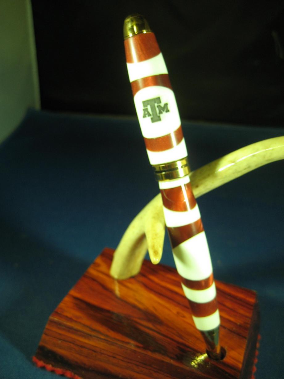

Problem with dyeing as suggested is that these pens are segmented with pieces of white Holly. The school colors are maroon and white. Dyeing while turning will dye the Holly as well as the Maple. I need to dye the Maple blanks before turning with enough penetration to hold the color through turning. See the attached pic to see what I am trying to explain.
This is an acrylic pen and I need to make something similar in wood. Bloodwood is close but I really want a real maroon.
Thanks for your suggestions. Looks like I may have to get a pressure pot.
A note on preventing maroon sanding dust from building up on the while holly: I have a similar problem currently and found that - if I get the blank close to the final size, then crank up the speed of the lathe to 3600+ and use a very very sharp chisel, it will be as smooth as 800 sandpaper or better. The problem with sandpaper is that it transfers sanding dust, but a very sharp square nosed chisel will cut it down to size cleanly without transferring sanding dust.
I have just finished my second pen this way, proving the first one was not a fluke.
