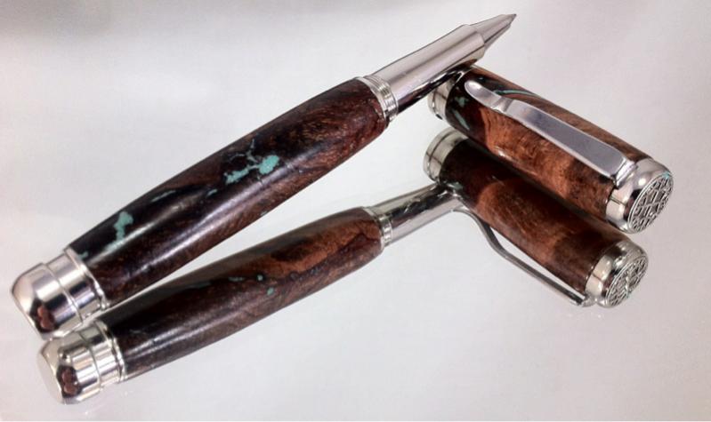

CB&D, I see some voids in the blanks. What are you going to use to fill them. I have some spalted Box Elder I was going to stabilize but they have voids as well and I don't know for sure how to fill the worm holes and other voids as I see in yours. If you would let me know how you are going to fill them I would appreciate it.
Tim.
That's the part I love !! The holes and voids....
I fill the with turquoise powder, magenta powder, some people even grind coffee and fill the holes.
Example below.
Do you have any Box elder up for grabs......please...lol
