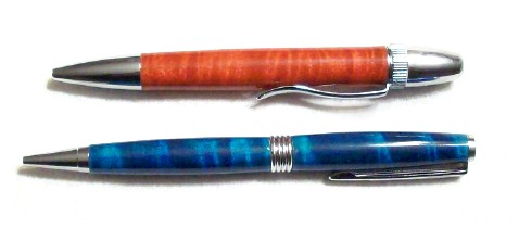

I've tried several brands of FC with suger in them and had poor results with all , blotching is just one of them . I get the deepest color by using McCormics Food Coloring and Egg Dye . It's as thin as water and penetrates the wood well and really brings the chatoyance out in curly woods .
