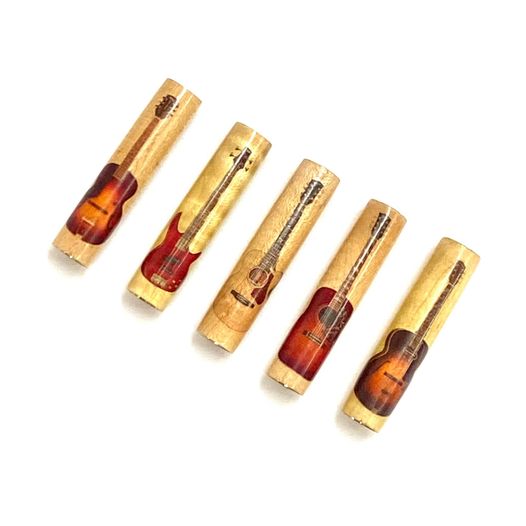

Testors no longer supplying Clear or white Waterslide decal paper I now use Sunnyscopa Inkjet decal paper
with better results than Testors decal paper ever had.
Finished up a few Sierra series pen
blanks using mostly Curly Maple
and some Birdseye Maple

They look good. I've been thinking of trying this due to people requesting themed pens that you can't really find kits for (aviation themed for example). Is that CA, polish, apply decal, more CA to finish/protect it?
Todd,
These are done using MINWAX WBOM Clear Gloss Polyurethane applied using my Dipping Method.
Les

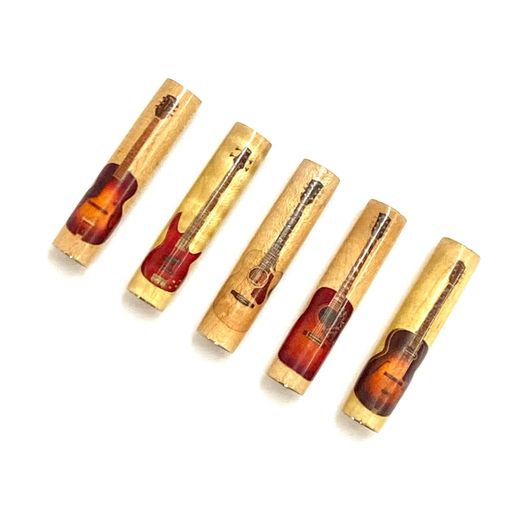

Finished up a few Sierra series pen View attachment 316838 blanks using mostly Curly Maple View attachment 316839 and some Birdseye Maple View attachment 316840.
Les
