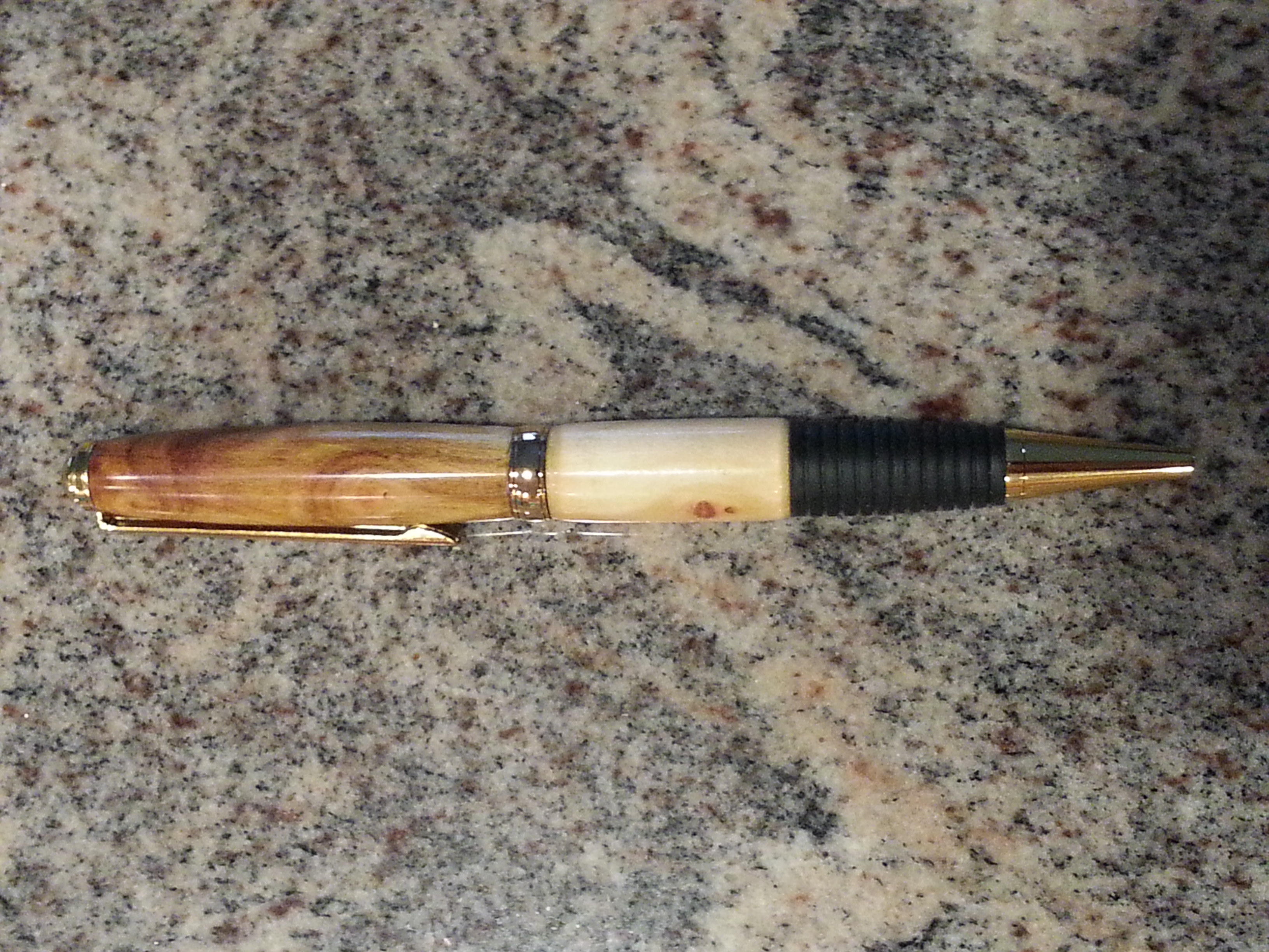

Thanks for the tips. I did make one a while back and loved how it turned out. Not sure how long it will hold up. Used BLO and CA finish. I cut it the branch (midpoint), kept it in my heated shop for about 6 months with the exposed ends glued with plain wood glue. Think 6 months is enough?
What this is all about is: I really don't want to be making anything that will be falling apart (with reasonable care) in a year.
