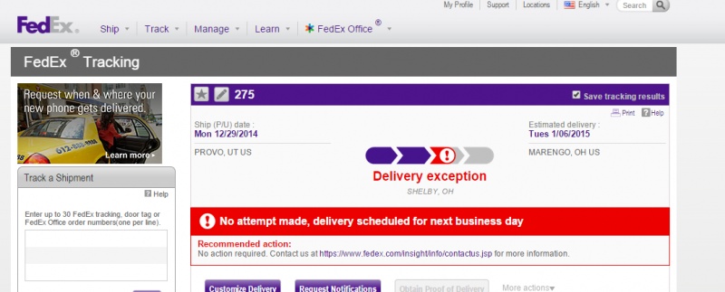

Hmmm, after a tech call and voila!, another update at FedEx. Those of you who track packages online may have seen this status but I never have before. This is just minutes ago! I don't know if Craft Supllies was able to contact them but it looks like the package may be out of the dreaded "Rural Ohio New Year's Party" black hole. I guess I'll find out tomorrow.
