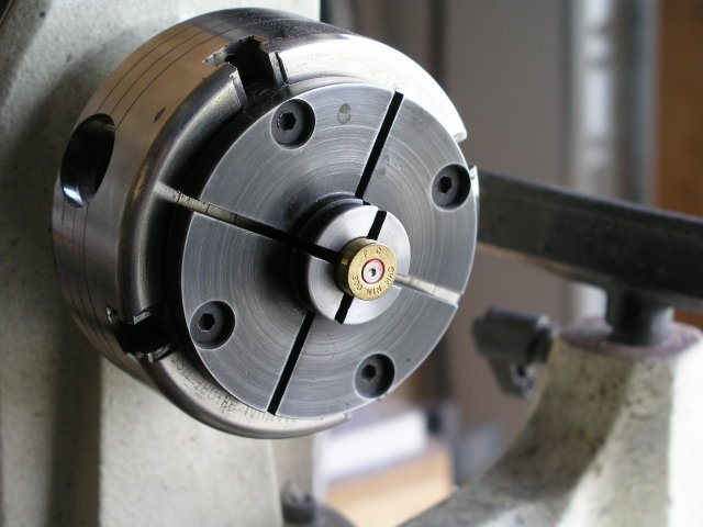

The easiest way to drill them is on the lathe. I have a couple different setups. If you have a Supernova Scroll Chuck or similar chuck, there are dowel or pin jaws available. Here is a photo fo a 300 win mag in the jaws:
NOTE: The primer was not removed prior to the photos. I use a small punch to knock them out first!

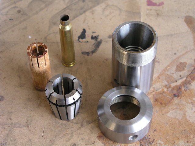

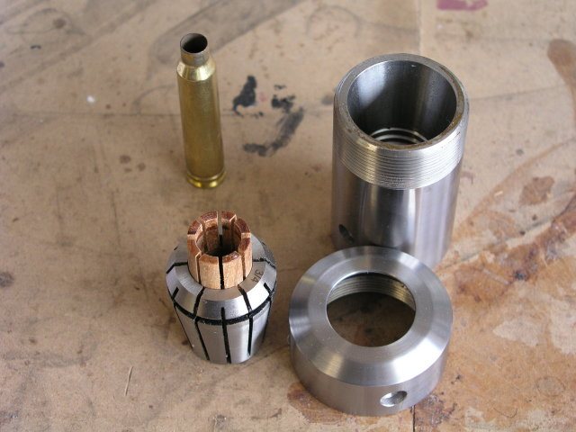

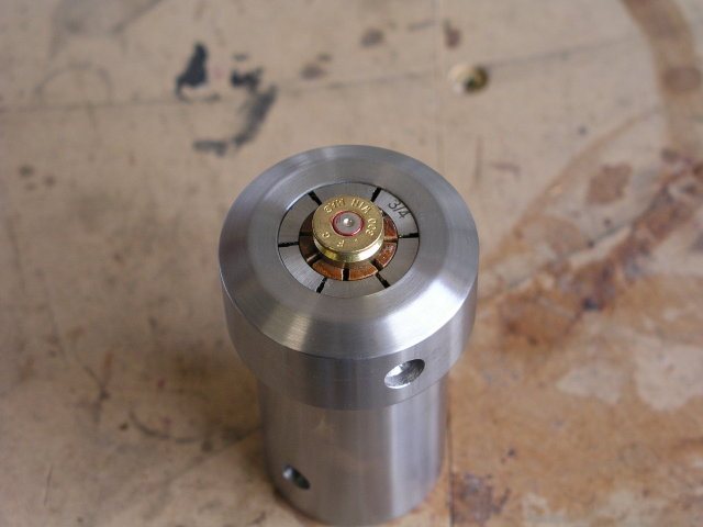

For my 300's,. I turned a collet insert for my Beall Collet Chuck, from and idea that Eagle mentioned to me. I use the 3/4" collet inside of the chuck. The insert was drilled to the proper ID to just slide over the casing. Then the insert and the casing are placed into the collet assembly. This works best by far and does not mar the outer surface of the casing.

James, you're killing me here. I had just about talked myself out of buying a Beall and you go and post something like this. Thanks for costing me even more money. [:p] Now LOML will have even more reason to make me sleep in the shop. [:0]

Originally posted by Fangar<br />The easiest way to drill them is on the lathe. I have a couple different setups. If you have a Supernova Scroll Chuck or similar chuck, there are dowel or pin jaws available......
Another one for you, James. How does the SN chuck do as far as protecting the surface of the cartridge? Seems like your wooden insert would be useful in that
set-up as well??
Originally posted by alamocdc<br />James, you're killing me here. I had just about talked myself out of buying a Beall and you go and post something like this. Thanks for costing me even more money. [:p] Now LOML will have even more reason to make me sleep in the shop. [:0]
Right on, Billy!! I have been trying to talk myself out of buying one of those ever since Charles put them in his I-store at such a good price. So far, I'm not having much luck.[V] Only thing that has stopped me so far is the fact there is a real nice wire welder on eBay that needs a new home!![:D]

Originally posted by Fangar<br />... This works best by far and does <b>"NOT"</b> mar the outer surface of the casing.

It really is useful, especially when you get all the collets. I now use it to hold my 5/8" aluminum stock for drilling too.

Believe it or not, the SN chuck with those jaws really does not mar the casing really. Usually it buffs right off prior to powdercoating, but you are right a similar insert could be used in that too.
