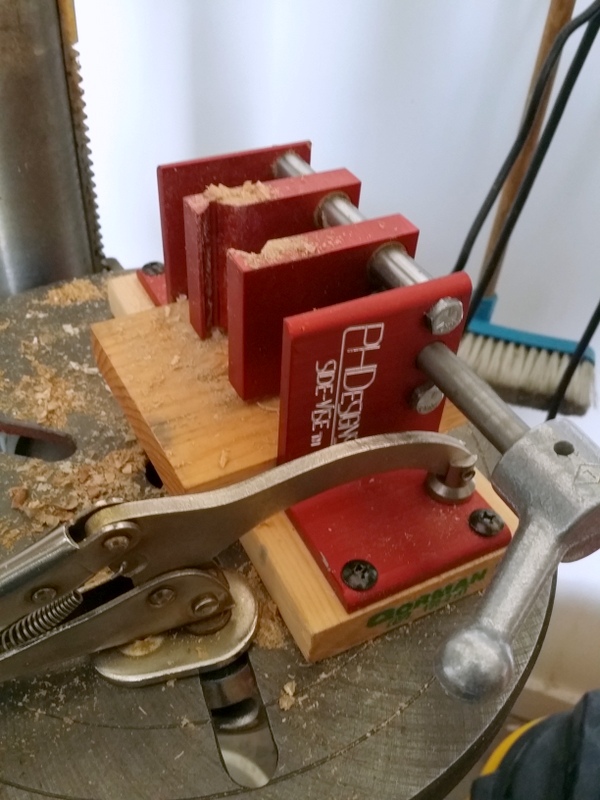

I have no acrylic blowouts. I use plain old, cheap, HD drill bits. I hold my blanks in an excellent pen vise. The bottom of the bank is supported by a sacrificial piece of wood which prevents the blowout.
