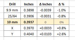

Your Tip is Outstanding. I do something similar with the instructions, but lately I've started re-writing some of the instructions so I can put in some step-by-step stuff I learned from Ed at Exotic Blanks, to match grain on rollerball pens for example. I also add a little bracketed chart that shows the specified drill size along with the "closest" bits going both larger and smaller for each tube - like this one for 10mm:

I like this chat idea. Giving you a quick reference for utilizing a different drill bit of you need to adjust for any reason.
