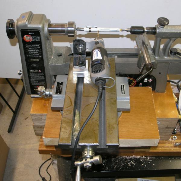

Are you looking for something like this?
It is made to fit a taig style tool post..

With the cross slide and the "gadget" that Skip Rat came up with that had a small index wheel that had about 5 or 6 holes would make a pretty decent rig.
On Edit
Look at this http://www.penturners.org/forum/showthread.php?t=39683&highlight=simple+pen+mill
With the cross slide and a similar rig up the indexing and the drill spacing could be controlled. Might want a higher dollar cross slide than the Harbor Freight version, but I would say it would be a pretty good beginners choice.
