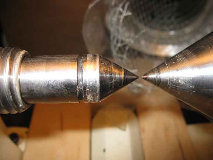

Ryan, have you tried checking the alignment by bringing the two centers together ?
It should look like this ...
I will try that but if i recall correctly last time i did that they were a little off... can that be fixed.. sorry for all the questions I am only 17 and i dont know anyone into pen turning besides the helpful people on this site

On my Jet mini the headstock is bolted to the bed in four places. By loosening the bolts it's possible to "adjust" the alignment between the centers ... at least the side to side part .... the vertical alignment is a whole other story. It would also pay to check that your morse tapers (where your centers slide in) are clean. A little gunk or debris in there can throw things off.
