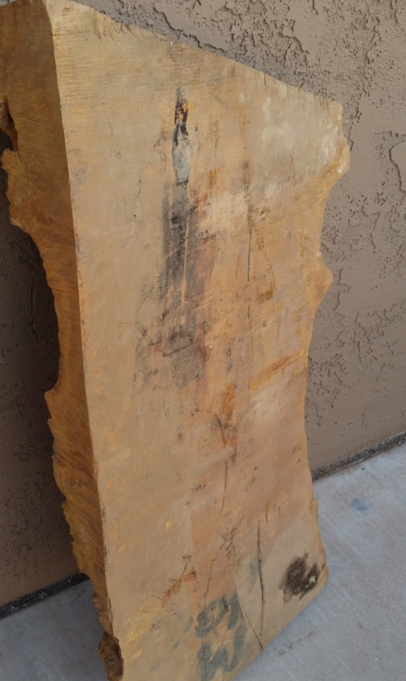

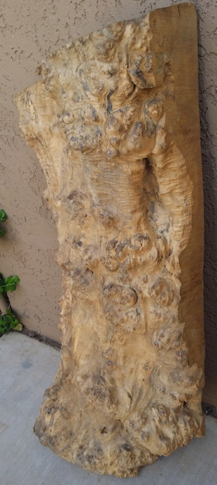

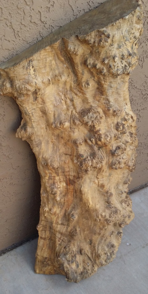

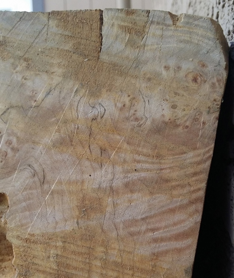

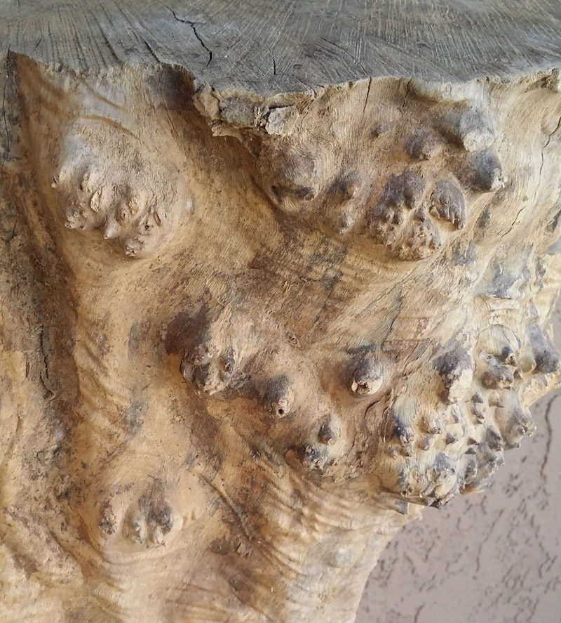

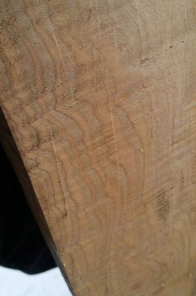

Here are some pics of the burl log. I took a block plane to some of the flat sections and you can start to see some of the grain. Harder to see exactly what might be under the actual burl sections until you cut into them.
My first thoughts are to get at least a couple of good sized, deep, bowl blanks from the top and bottom which are the widest sections. The middle should yield one or two shallower bowls or platters. I would love to see if I can find a few blanks big enough for a few peppermills.
Once I mark off these larger areas there will be plenty of space to create a good lot of pen and stopper blanks.
All other thoughts welcome.

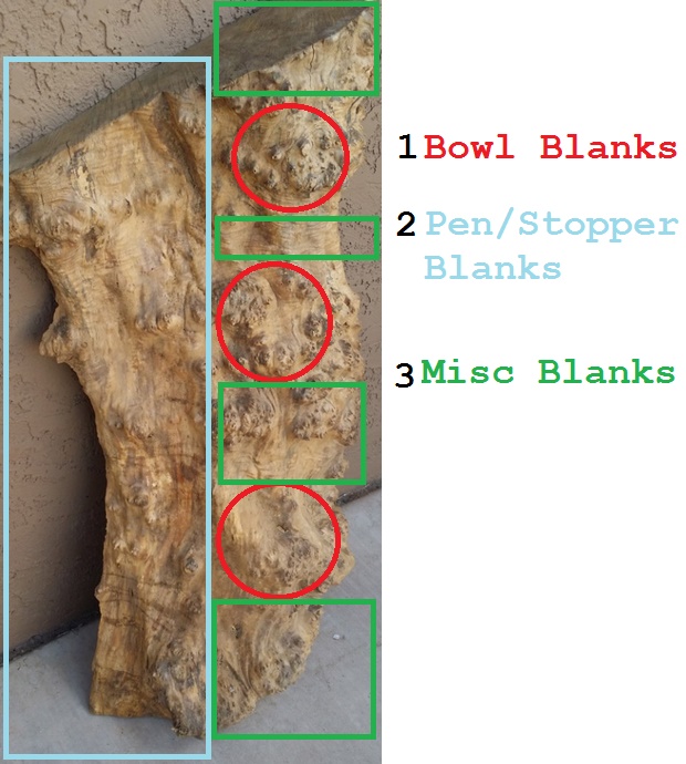

Oh. nice ... what you've got there is something I'd call "curl and burl" -- even the parts that don't have much in the way of burl eyes and/or swirly grain have got that curly maple thing going on.
I'd try to section it out sort of like this ....
As you wish to prioritize bowl blanks, you'll want to cut them first:
attachment.php
Next, I'ld see about getting the stopper blanks out of the remainder, and ending with salvaging your pen blanks and offcuts for casting.
If you have a system set up to hollow your bowls and save the bowl core, that would be the most efficient use for your wood, as you will get multiple bowl blanks from each of the three bulging sections of burl.
The long thinner section to the left would be ideal for pen and stopper blanks ... if the stopper blank doesn't look to be spot-on, merely split it into quarters and use the good parts for pen blanks. As such, your stopper blanks will likely be best set up as 1.5" square, 5 - 6 inches long (or longer) ... so that if you decide to make them pen blanks, you have the length on them to accommodate your needs. As you make stoppers, just cut the desired length off of the larger blanks as needed rather than cutting them all at once.
The spaces between the bowls in the thick sections will make for some highly prized pen blanks, stopper blanks, and turning spindle projects.
I wish you the best of luck in portioning this thing out, and don't forget to wait for others to chime in on what they think would be the best ways to section your burl up ... mine might not be the best idea on the cutting block! :)

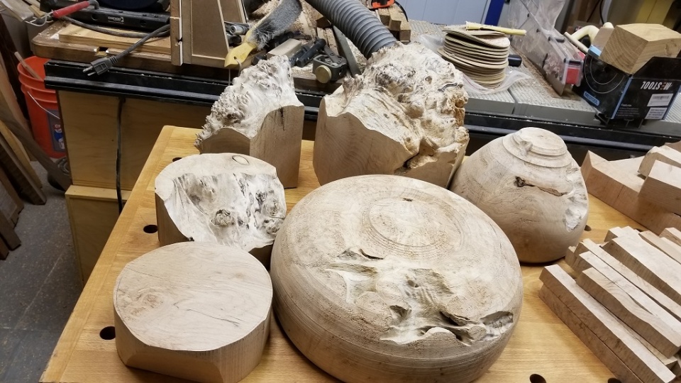

So things got crazy busy in the middle of this year. Had lots of day job getting in the way, LOML broke her ankle and we recently got back from a 5 week 5500 mile workation RV trip. Just about caught up now and am planning for a few good art and crafts fairs in the run up to the holidays.

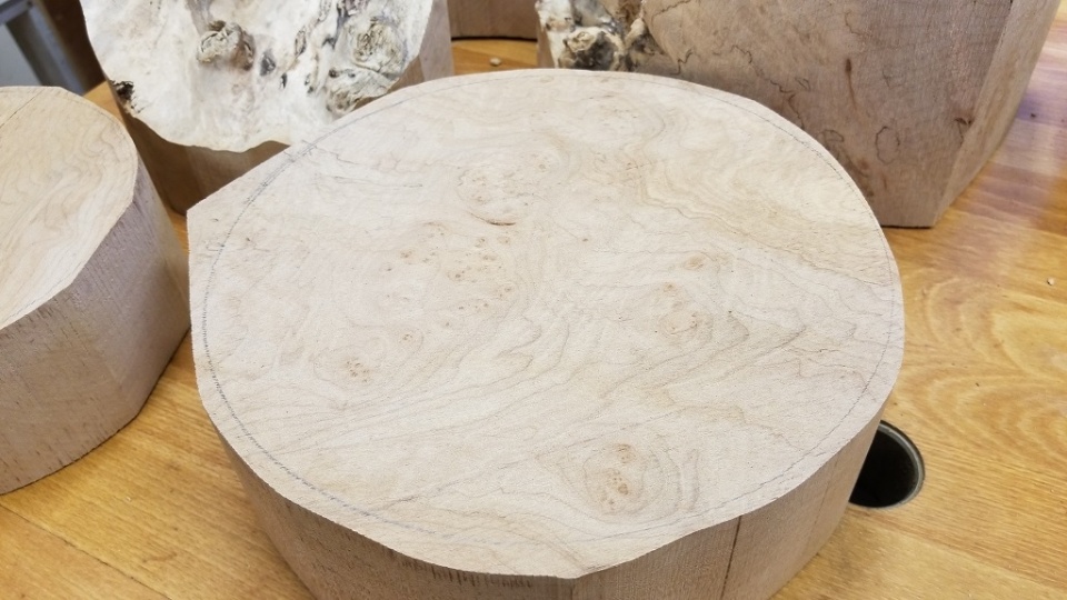

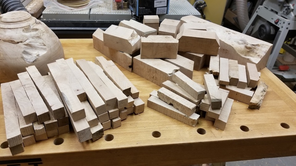

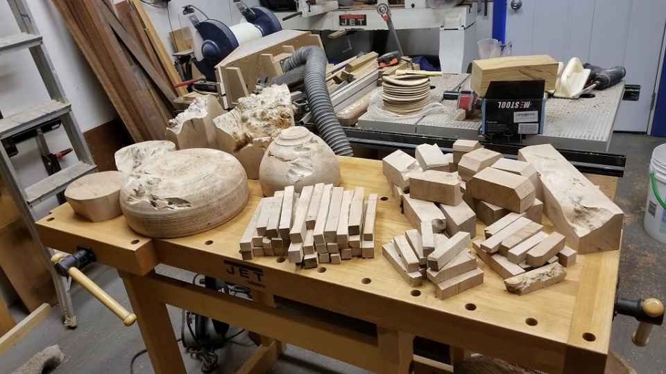

I finally managed to get this large chunk of maple onto the bandsaw and here is what I yielded.
6-7 bowl blanks including a nice 12" one
1 3x3 that should become one or two pepper mills
A bunch of 2x2s that will turn into bottle stoppers or condiment shakers
Approx 36 long pen blanks - These are 7"-9" so might even yield 2 pens from some.
Approx 30 short pen blanks.
Here are some pics. You can see I roughed the outside of a couple of the bowl blanks. Not sure whether to leave the imperfections or turn them out. Similarly the 8.5" bowl (back right) is rather tall so not sure if I should make one very deep bowl or cut it in half and make 2 shallower bowls. All thoughts welcome.

Something I am noticing more and more: where there are inclusions - cleaning it and then filling with colored cast resins or turquoise powder or something.
I noticed that you had rough turned the bowls and there were some shallow spots. Keep an open mind whether to turn those shallow spots out, fill them or leave the natural edge. It will be something special no matter what.
I am not suggesting that you do this (buy more tools) but there are some chisels with curved blades that will rough hollow a bowl and basically make rough turned "nested" bowls - i.e. let you get two bowls from one blank.

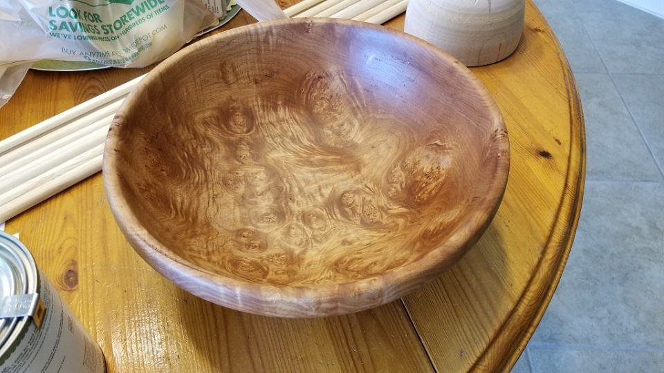

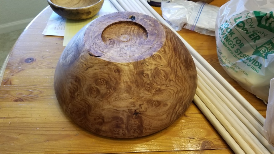

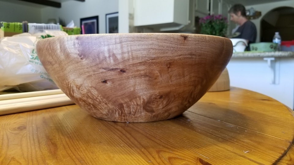

Still deciding what to do with some of the pieces. The large piece is now a nearly finished bowl. Had some issues with tearout but managed to get rif of most of it.
