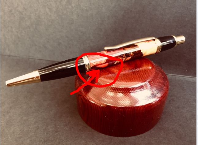

Speaking as a newbee and new to casting, from my experience pine cones need to be stabilized because they are so porous. I found that when i reverse painted the blank after drilling before putting in the tube the paint bled through in some spots and became part of the finished product. Not the end of the world but a surprise if you're not expecting it. Maybe use a q-tip with CA to coat the inside of the blank of you're gonna paint it.
