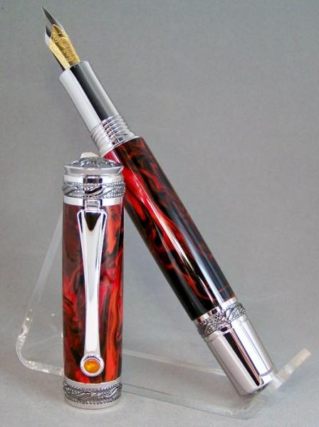

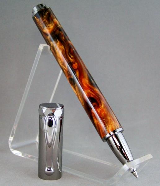

Thanks Bill, yeah I'd be happy to help. That might even be my blank you're referring to on exotics. I've got these 2 that could fit the bill. If they'll work for you let me know and I'll get it taken care of.

The right picture is excellent, who & where can I get a couple of these?

Seriously the "Inferno" blank on the right in photos above is a dead ringer for a firefighter. It is my opinion you are not going to find a better one.

OK, a report: I received the blanks from Brooks308 and they looked super right out of the box. I got 2 of each that he showed in this posting and yesterday I drilled and reverse painted (painted the hole drilled with flat black plastic model paint using a Q-tip and spray painted the tubes) and waited till today to turn them. I also cut the blanks at a 30deg angle and attached a piece of pure white acrylic seperated from the "fire" by a thin piece of aluminum. My plan is to apply a decal indicating a local fire department logo on the white but have not received approval to use it yet. The blanks turned easily kinda like a cross between acrylic acetate and acrelester. I sanded with 320 followed by all 9 Micro Mesh grades but have not polished with Novus yet. I will final polish after the decal is applied, sealed with CA and have re-assembled the kit (I'm using an upgraded cigar in gunmetal)..I turned one each or both blanks and they looks really cool. I like the blank on the right in Brooks post best and wonder if painting the hole and tube red would give it a more fire like look. I'll try that next. Thanks Brooks, good service and good product.
