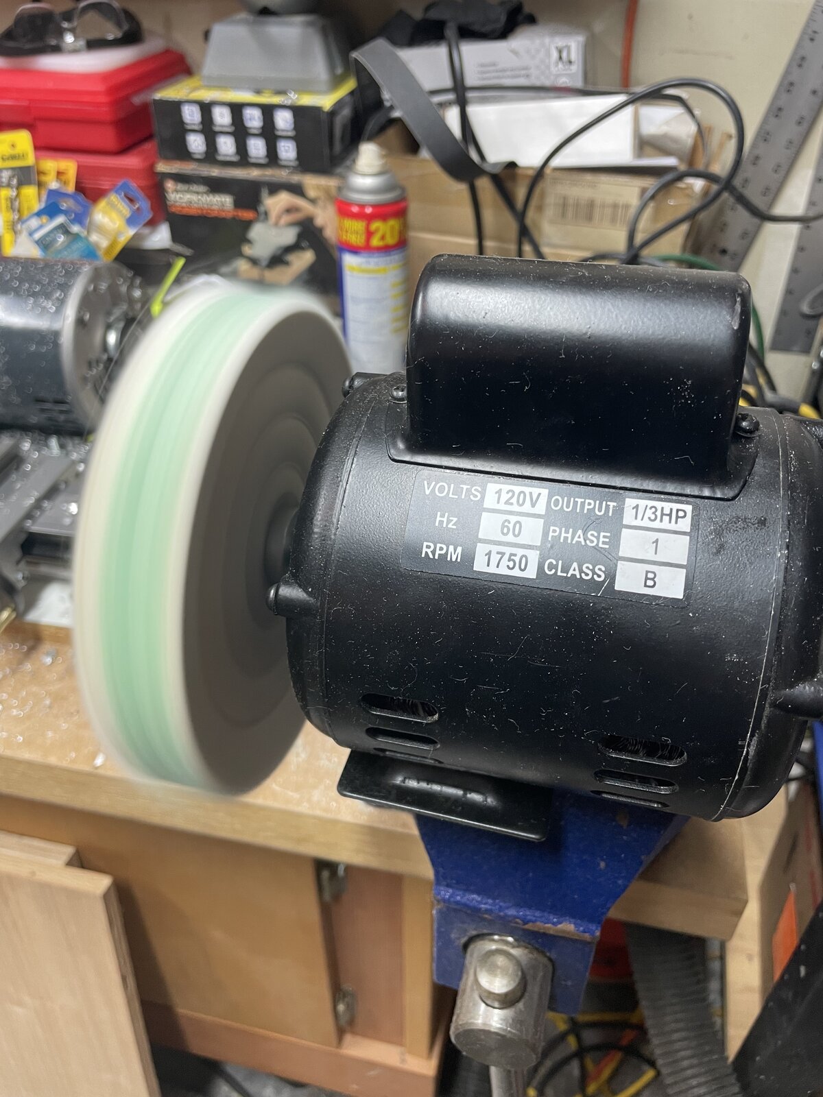

Todays project was finishing the disassembly of the old bench top drill press that failed a few weeks ago. I had already repurposed the base/stand.
Today I turned some spacers with set screws and converted it in to a buffer using the buffing wheels from Niles. It's currently chucked in a vice but I plan on making a base plate for it. I may try to thread the shaft to use nuts to hold the wheel but the current cheap 1/2" die I have was having no part of threading the stainless shaft. The shaft has a flat spot that the set screws purchase against and it's easy enough to push the outside spacer in to the wheel. I suppose that will help prevent heat buildup - if the wheel slips, I'm pushing the pens into it too hard.

I like it. Mine is an old stand upright sump pump motor. Took motor off and mounted on a board and fine to go. The sump switch works fine for on and off. Be surprised what you can make from throw aways.;)
I think I'm going to mount a junction box/switch once I get it mounted. The real question is how much improvement I might see over my current polishing process 🙂
Have to say I do not polish my pens on a buffer. I tried it once because of the push here on the site. But I found 2 things it made no difference and two they could become slingshot material very quickly. I use my buffer to polish some of my scrollsaw bases when I use oily woods.
My thought was I'll finish the bodies down with micro mesh and Novus polish - then put them on the mandrel to try the polish. We'll see how it works.
Just be careful because it will burn through a finish real quick. Also as I said they do launch well.
Yeah - plan on being very gentle. And like I mentioned, I can keep the wheel a little loose to protect from getting too aggressive.
I've had more problems with the buffer flinging beautifully finished items across the shop than I have with burning through finish.
Some of the videos show people very aggressively forcing pieces into the spinning wheel, but my experience is that a light touch works far better. Be especially careful with corners and edges - they tend to catch on the wheel - and hold the piece as tightly as you can. But like anything else in tuning, the first few times tend to be less successful - you have to practice until you finally learn how to do it. And it seems like having a stock of a few bad words to release tension also helps!
I've practiced a little bit on throw away blanks, and I have a couple of almost finished blanks to use as well. Last thing I want is to zing a proper one across the room. I've also been able to make the wheel spin on the mandrel my easily if I keep the collars too loose.

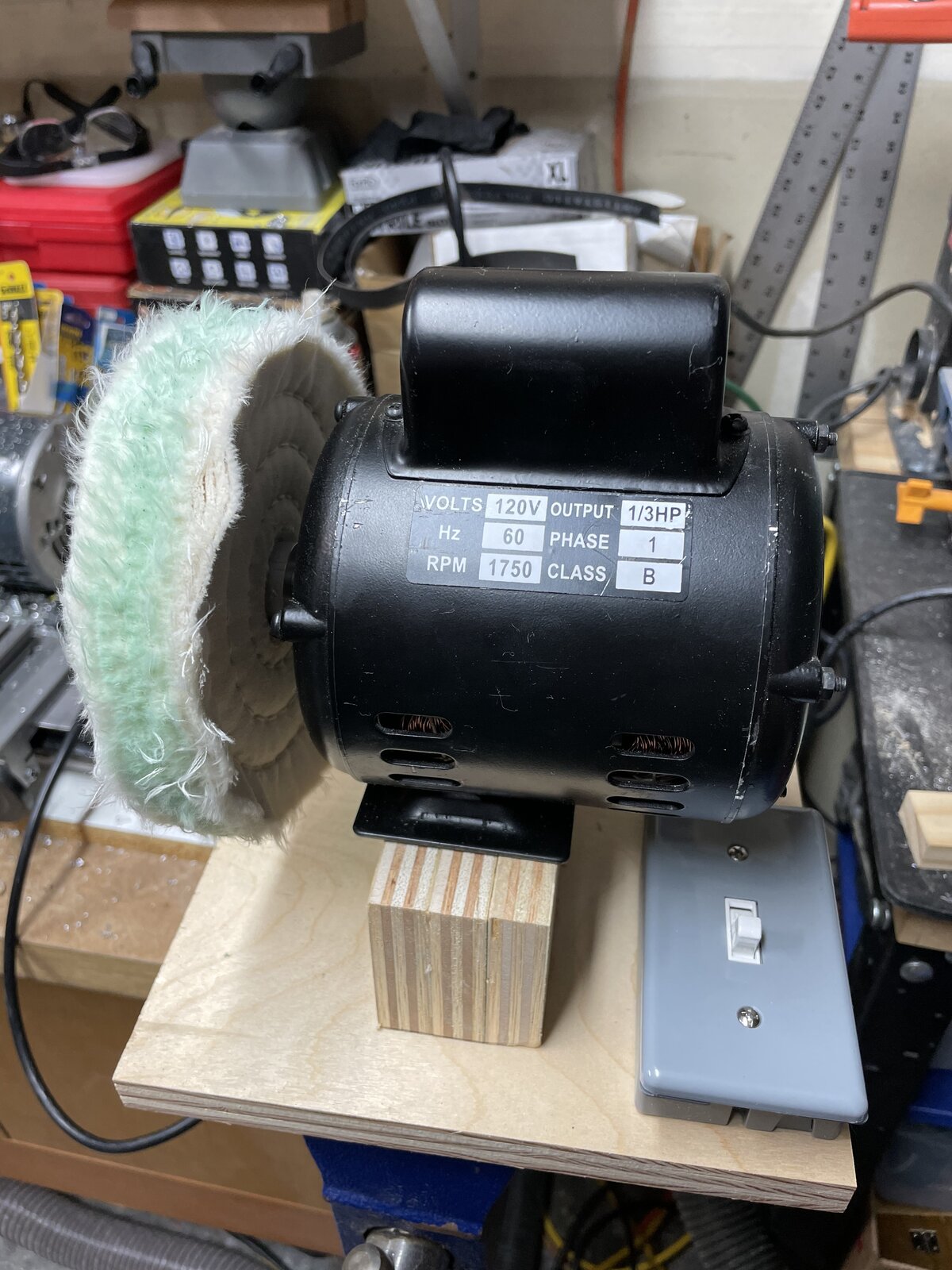

Finished up the base and switch box today. Works like a champ and the buffing wheel slips on the shaft about the point it would grab something.
