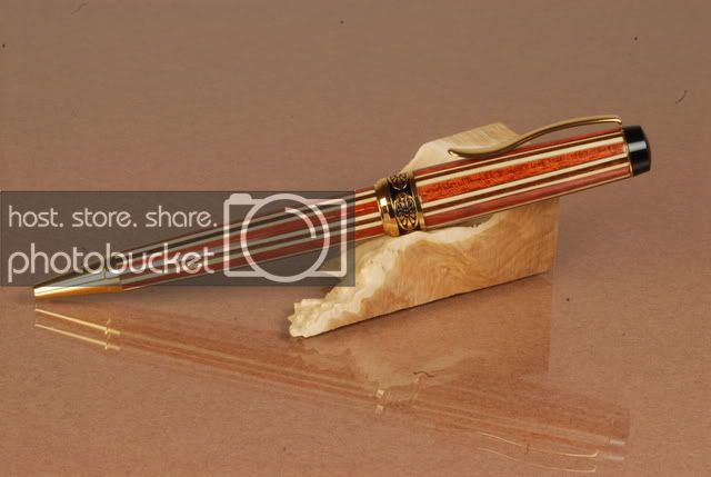

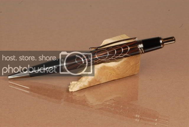

I think my sensor has some dirt on it. I have cleaned both sides of the lens and the dirt is still there, so I'm guessing it is on the sensor.
How do I go about cleaning it? Thanks in advance for your advice.

BTW if you have any comments/critiques on the pictures above I would greatly appreciate your input. As I said I am new to digital and also new to photographing this sort of subject matter.

I keep a UV filter on the lens for protection but am taking it off the lens when I am taking pictures of my pens.
