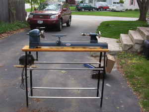

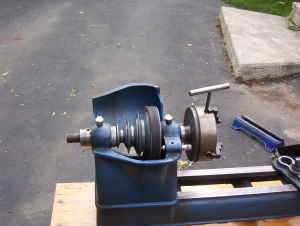

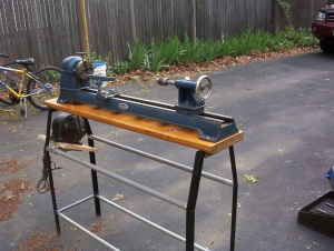

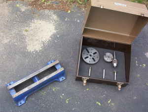

Here is the lathe I picked up, its an old craftsman. It came with a Westinghouse motor , a 15" bed extention, a 4 jaw chuck, 2 Keyless No. 1 Morse Drill chucks, 3 dead centers and a face plate ... I think it was a deal for $150.00

I have the exact same lathe. I think a router control is perfectly accaptable to use to regulate motors. Besides with the divorced motor any dishwasher/washing machine motor will work fine. Mine is a 1936 atlas sold by sears.
