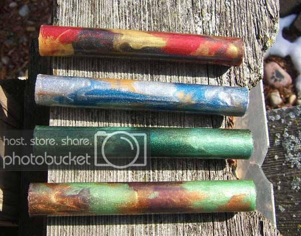

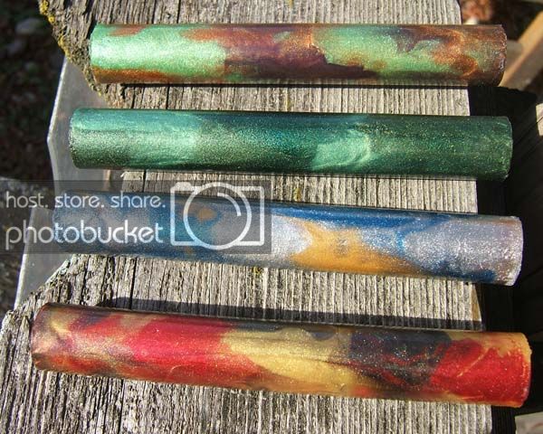

I'm slowly building up my blank inventory and had some time to turn some liquid to a solid yesterday. They're not as impressive as I had hoped, but it's hard to tell what they will look like when finished. I hope better than they look now. The green looks plain, but it has four different greens in it. Maybe they will show when it gets made into a pen?
Anyway, when I was prototyping, we had a commercial oven of sorts to do rapid cures. It didn't have an open flame or element, it just had hot, dry air feeding it from an outside source. I built a crude hot box to help defeat the cold temperatures in my work space. I'm sure the casters know that cold resin doesn't play well, it will trap air pockets along with a very slow gel and cure. The hot box worked well, it maintained a temperature between 85 and 90 degrees. I will spend some time to refine the hot box and make improvements now that I'm confident it works well.
Now the photos of the finished blanks.

I'm thinking you will be really pleased with the outcome of these, particularly the top and bottom ones :)
Thanks for the tip on the heated box
I agree; those should look fantastic. Do you cast them one at a time, or do you pour multiples of each color scheme? I ask because I found it easier to do 6 of a color scheme in one pour.

I only cast a single blank of any given color. I do that for a few reasons, I'm trying to stretch my resin as much as I can, I don't really need a bunch of blanks of the same color. I make these for myself, so as previously stated, I really don't need a lot of the same color. Also, I have short windows of time to cast.

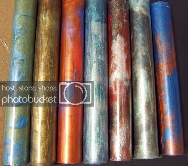

I spent some more time yesterday after dinner making a few more pen blanks. They're not as nice as some I've seen around here, but they are fun to make. It's rainy out, so these photos are from inside.
