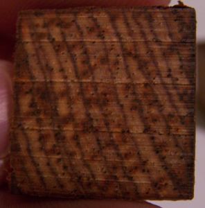

As promised, here is a pic. This is the best I could do. My software has a hard time resizing pictures down small enough to post.
On this particular blank, there is a visible band of dark reddish coloring evenly around the entire blank, like if a liquid had soaked into the blank. There are also streaks of the color lengthwise through the blank following the open parts of the grain.

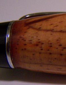

This is the pic of the pen I made last night. The coloration doesn't seem natural. Too much light, almost white wood with streaks of reddish brown. If you look at the end of the pen which was the end of the blank, it is almost completely dark.
Here is a closeup of the end.
I do not want to be called a crazy person, but when I tell a customer that I am selling them a pen made from XXX wood, well, you know my emotional/moral delima. If wood has been doctored to make it look better when you open the package, I'm not interested.

It's hard to know (as you yourself can see) what we will find inside of a piece
of wood.
HOWEVER.. the person doing the milling can see it. If this was a group buy, the
chances are pretty good that whoever did the milling knew where the two tone
was happening and cut accordingly. If they knew it was for pen blanks, that's not
so good. But chances are, this had nothing to do with the person putting together
the group buy. They wouldn't have any way of knowing what is inside the blank
any more than you would.
But cocobolo also shows dramatic variations in color within the same piece of wood.
It will also change color after being cut and exposed to air. (but not likely from
white to dark brown)

Have you cross cut (diagonally) and sanded a blank to see if it might have been stained? If you have turned 10 blanks with similar results, this does not seem like a random color variation.
I have turned a lot of cocobolo and never seen it turn white. I have seen a lot of color from light orange to chocolate brown, to black, and even some grey, but never white.
BTW: If you need some cocobolo for projects your working on, send me a PM. I have some extras on hand and would be happy send some, if it gets you out of a jam.
Tim
I've found that coco frequently looks pale until it's finished. Give it a quick wipe with mineral spirits or DNA and see if it darkens. If so, you're probably fine. And it does darken over time all on its own.
I've seen that happen before with cocobolo. The pen I carry personally was like that. I bought a 3" x 24" board at Rocker because it showed some nice grain. When I ripped the first blank, I was so disappointed at the pale color that I almost didn't use the blank. The color changed quickly once the pen was turned, even after it was finished (CA). The pen is now very evenly colored, and it quite attractive.

I've had cocobolo be more of a light-orange color, but never whitish. The sapwood of cocobolo is quite light, perhaps that's it (though you would have seen that on the outside. A picture posted would go a long way!
Yes, Cocobolo will be very pale when first cut/turned. As it is exposed to oxygen/sunlight the colors come to life and can eventually get so dark that all the grain will be lost.
Set the pen aside for a while in the sun and see what happens.

I had a stopper blank I purchased from Rockler that looked similar to that. It looks as if the blank was soaked in BLO (or something of that nature), that darkened the surface grain of the blank.
I do believe you received cocobolo. However, I would not call that premium or "KING" cocobolo.
Try some DNA or Acetone to dilute the oil. That may help level the color.

I see no whitish wood in the PIX. I see some areas that are lighter than others but there is nothing unusual about that especially in Cocobolo which has wide color variation within the same board. As others have said, the wood is photosensitive like Padauk... exposure to light... especially UV will cause color changes.
I store all my Cocobolo and Padauk in a very dark area of the shop to retain the color that I liked when I bought the boards. I treat them with UV blocker when I finish them to retard the color change though I kinda know that it is inevitable especially if the wood is exposed to sunlight for any significant amount of time.
If the wood were dyed or stained, when you cut off a cross section as you prepped the blank for drilling, it would most likely have shown significant variation in the very center. The chips drilled out would have shown more of the original color as it is hard to penetrate the dye 100% throughout the blank. From the cross section you displayed, it doesn't look dyed or stained to me. Now I am not sure whether that is an exterior or interior cross section. I am talking about an interior section.
If you are not sure about the wood, sell it as a "Not Sure But I Think It Is Cocobolo" Give a $5 uncertainty discount and let the wood and craftsmanship sell itself. If the rest of the blanks give you an unacceptable result, maybe buy your Cocobolo from another supplier.
I prefer to buy boards I have visually inspected and mill them myself. That gives me a good picture of the original wood and a better shot at verifying the species. Even so... I mark each blank with a species code because sometimes it is sometimes very hard for me to tell one from the other. Is it Honduras Rosewood, Brazilian Rosewood, East Indian Rosewood, Cocobolo, Bocote or something else? I have all these woods and sometimes they look almost identical.
Bottom line... I wouldn't worry about it. Finish the blank with some oil and CA and it will be beautiful... and it will sell.

If that is a 3/4" blank, then it could be from the sapwood portion of a large piece.
The radius of the rings looks pretty wide. And, as mentioned above, it does appear
that oil or sealer is soaked into the wood.
It would be interesting to take two blanks with similar color, leave one in the sun for
a few weeks and then compare them.
It could be cocobolo, but not a blank I would necessarily buy (or sell)
Set it in the sun for a few hours. It will darken. I've seen a lot of cocobolo that was dark on the outside but was very light when freshly cut/turned. It will eventually darken to the same color as it originally was.

When I turn mine it usually is a black and white shades, after a week it turns to Oranges creams and dark stripes actually looks alot nicer after it is turned.
Sometime depends on where the tree was grown as to what colour the wood is, as Ive seen Cocobolo from different countries being different colours.
One was a very rich red, and one more of a paler orange dusty colour? Cant remember which two countries though! Possibly Mexico and Brazil? Dont quote me on that though!!
Ive had both, but never quite as pale as that, but then that might just be at the the pale end of the paler cocobolo type?
