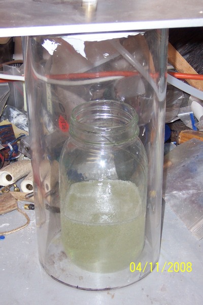

Hughbie,
The PR resin expands in volume about 15-20% or so. When I built my Vac Chamber, I used clear acrylic tube, for the sole purpose of being able to watch it. I have had a few overflows, especially late at night when my brains not working to great, and I fill the container to the brim. This pic a just a minute or two after I started pulling a vacuum. Thanks for the insight saturday at the turnathon, Don. I went to HF yesterday and was looking at the cleaner. I might have to give it a shot soon.
