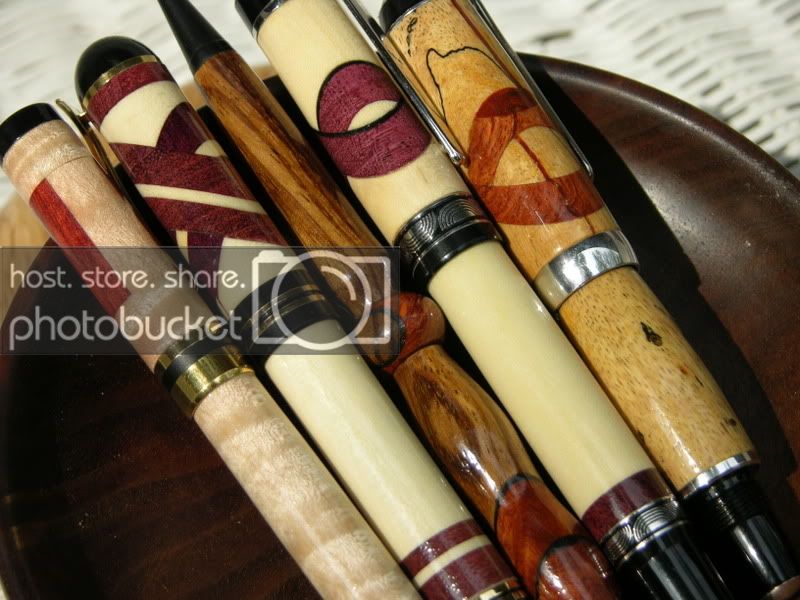

Meanwhile, not the better shot (i,'m a turner, not a photographer [:)]but it will give you an idea of the shining finish.

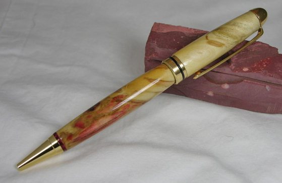

Here's the result with just plain old dipping.
