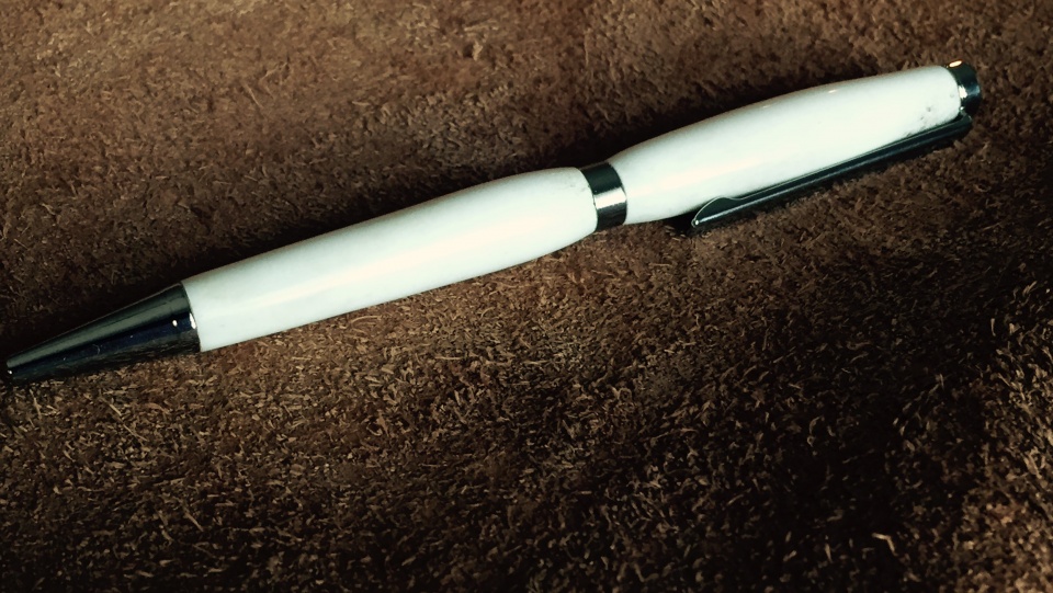

I've done a few antler pens. The tines and the main beam closest to the skull are usually more solid therefore will finish nicer as opposed to the other areas of the antler. The areas that are porous don't finish as nice. I believe you can fill the holes with ca as you get down to the finished product.

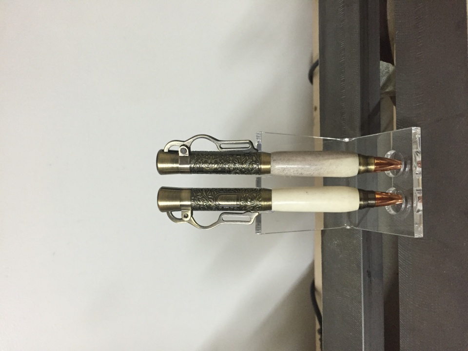

Try Axis deer antler, they are solid, and are real white and quiet heavy, but make nice white pens. I wish that I had a piece, I would send you one.
I agree that the Axis Antler will probably be your best bet. It's more solid with a small hole running close to the center. Check Knife Maker Supply Co. and I've even seen it at Pet Smarts. It was being sold as dog chews.It will sometimes have a light grey color streaked through it but for the most part it's a solid white.
