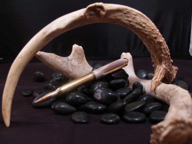

I have been putting together a deer antler-bullet pen... This is not a kit... I resized the 30-06 WW II vintage cartridge, drilled it, and also created the deer antler blank etc. I have made several of these and I consider them a tough pen to make... The antler is hard to drill since it is curved... It stinks and you need a respitator when turning... and I messed up more than one of these things... BUT it is a beautiful pen and folks love it... I bought a kit to try and I will see how it goes...

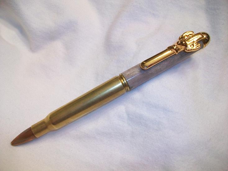

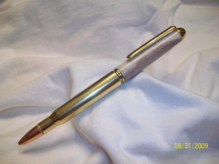

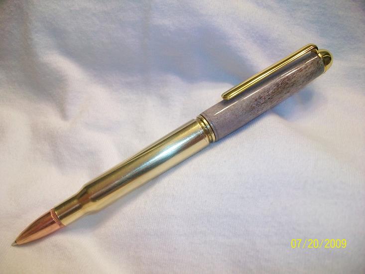

Nice picture display! I too make these pens and believe it or not, they are my number one seller, close to 50 made just last year! I turn the antler between center as well, then drill, much easier that way. However, I prefer the tru bullet as the nib, sort of finishes it off better to me. (just my preference)

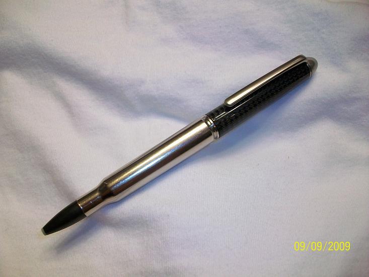

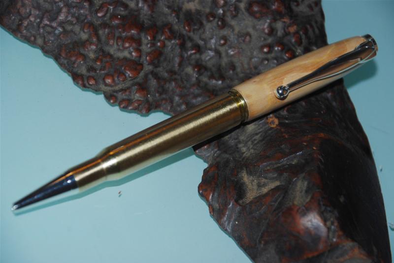

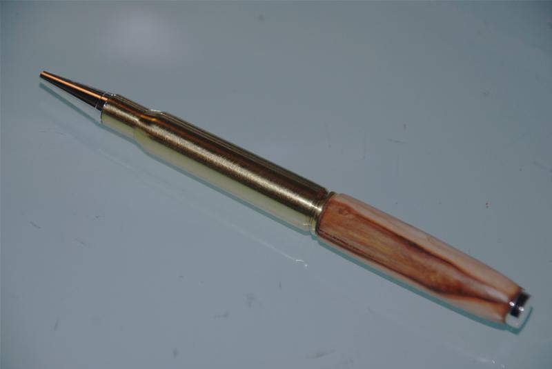

Some people like the raw brass and allow it to tarnish. For the ones protected I use spray shellac.Pens - 2-1-10 Bullet Manzanita A+.jpg
A disclaimer that fits in the bag that accompanies the pen upon sale, states that it might not be protected and to use 0000 steel wool or Brasso to brighten it up.
When on the lathe, I use garnet 320, 400, 600, 1500, 2000, steel wool and then Brasso to get a smooth soft luster.
