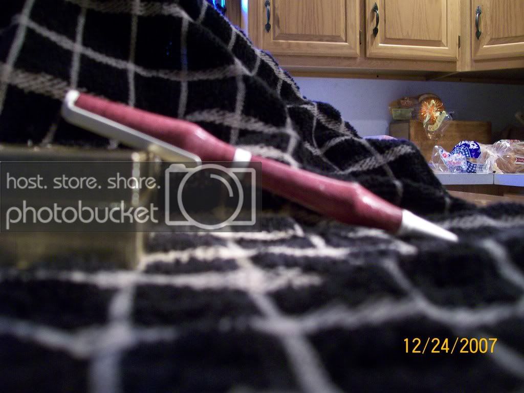

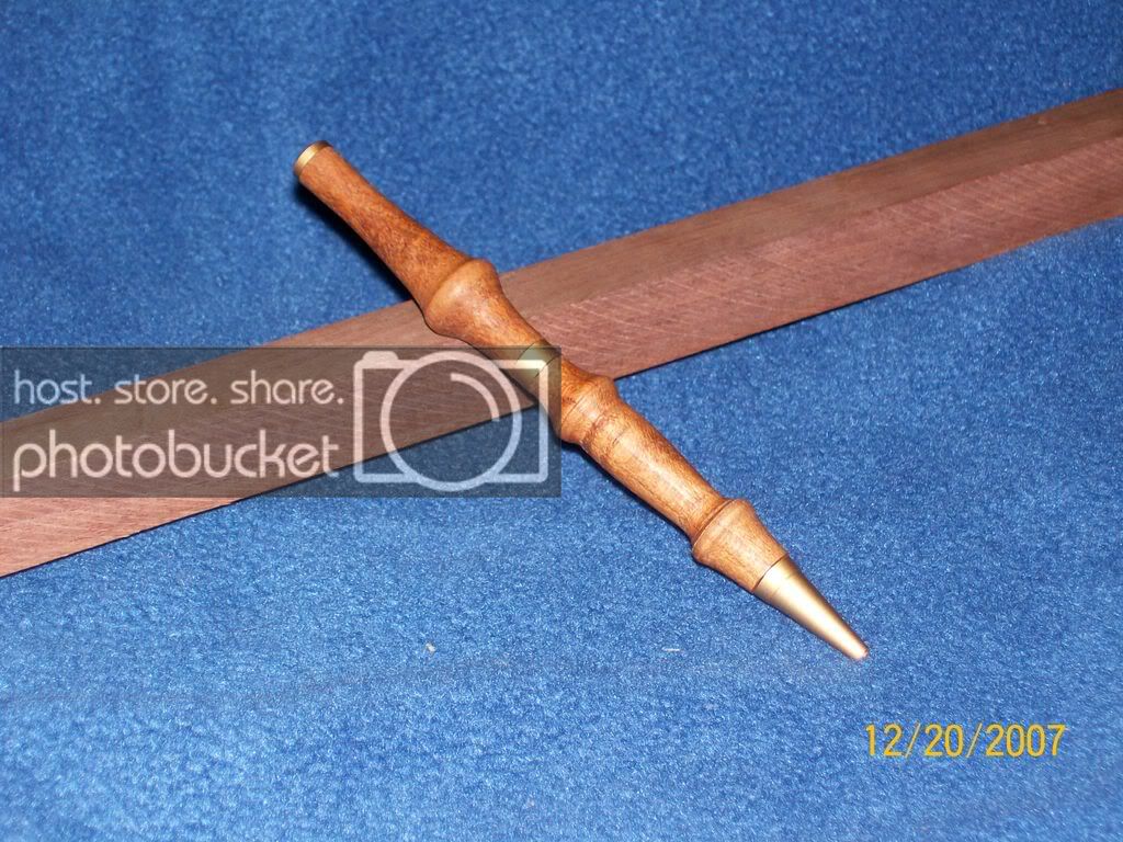

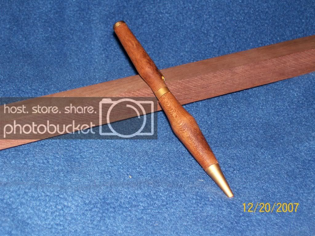

I have pens I need to shoot, but when my camera is close enough to get the detail I want, it doesn't know what to focus on and I cant force the close focus because I dont have a Macro setting. can I get decent pics w/o it? these are my best:
those were my best but even they were hard to come by
The short answer is no, not without a lot of cropping which is not likely to get you very good results. What kind of camera do you have?

The top 2 are pretty good.. the bottom isn't so hot... If you post your model camera - we can post better tips. I usually lookup things like minimum focus distance based on model.
I agree the top two aren't bad the last one needs help.

Until you get a better camera, your best bet is to lose all the busy backgrounds. Use something without texture, preferably white, and get a really un-detailed pen prop. I've got the same problem with one of my older cameras, and I've found that if I take away all of the alternate focus points, it finally decides that the pen is the best thing to focus on.

The specs on dpreview.com say your camera does have a macro mode and will focus as close as 13cm. There should be a flower symbol on one of the buttons on the camera. Use it and move in close enough to get rid of most of the extraneous background. Orient the pens diagonally in the viewfinder and keep the pen as parallel as possible to the back of the camera.
Well, hot damn! there is a macro setting on there! And in a very obvious spot that I should've noticed. Shows what I've learned after two quarters of Forensic Photography
