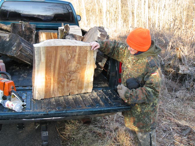

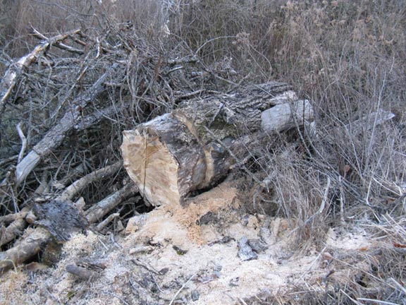

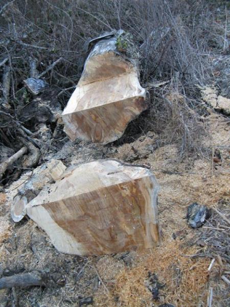

This tree turned into a two day job. Looks like three truck loads.
Thought you folks might like to see the last load we cut this morning.
We are going to spend the afternoon resawing and stacking this blanks for storage.
Here's a couple of pics---the blank on the tailgate will end up as a popcorn bowl----Yup a biggin:biggrin:

Dang Gary that is gonna be one big popcorn bowl.You must really like popcorn.Or just wanna make a big bowl.Nice looking wood you have there,any desire to share?You know,spread the wealth a little.:biggrin:
Ronald ---that's a good ideal------I could cut blocks out of the center so they would be all heart wood and sell them. That tree is over a 100 years old and the wood has some great color.
The popcorn bowl will just go into our showroom inventory---I just like making the monsters even though they don't really sell very well.

Gary,That's some fine looking wood,am I the only one who sees a face in the wood in the last pic?no I'm not smoking anything.
Where the tree forked and went 6 directions it was about 5 foot thick---you would not believe some of the wood that came from that section of the tree.
I am going to let the wood sit for a couple of weeks and adjust to the shops enviroment before I turn any of it.
